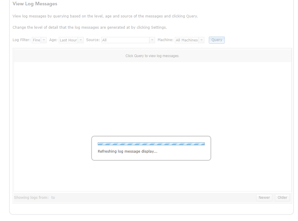

Hi,
Somehow our ArcGIS Server doesn't return logs anymore. This is the case in the manager and on the REST endpoint (which is no surprise, as the manager seems to use this endpoint as well). Instead of logs the server is just infinitely 'pending':
Does anyone have an idea of what te problem could be? Tried rebooting the server but this didn't help.

Hi Greco,
In addition to what Christof wrote above, I would make sure that the account running the ArcGIS Server service has access to the logs directory. From the web page you included in the screenshot, you should see a "Settings" icon in the upper right hand corner. Clicking this button will indicate the directory where the ArcGIS Server logs are stored. (By default, this is "C:\arcgisserver\logs\").
If you browse to that directory, do you see the logs being generated? Does the service account running ArcGIS Server have read/write permissions to that directory?

GercoFlonk
Thanks for the replies.
Some info:
Server version: 10.7.1
There is 87GB of space left
Logs are being generated
We did resolve the issue this morning. The VPS on which the datastore was installed was not responding/operating correctly. After rebooting the VPS everything operated normally. The logs are now available in the manager and on the REST-endpoint.
Even though we fixed the issue, we're not quite sure what role the datastore has in correlation to the logging and why an unreachable datastore(server) would impact the retrieval of the logs. Maybe you could shine some light on this.
