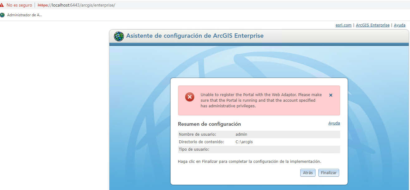

I am installing ArcGis Enterprise Builder 10.8.1, all good until step 4, then I get an error.

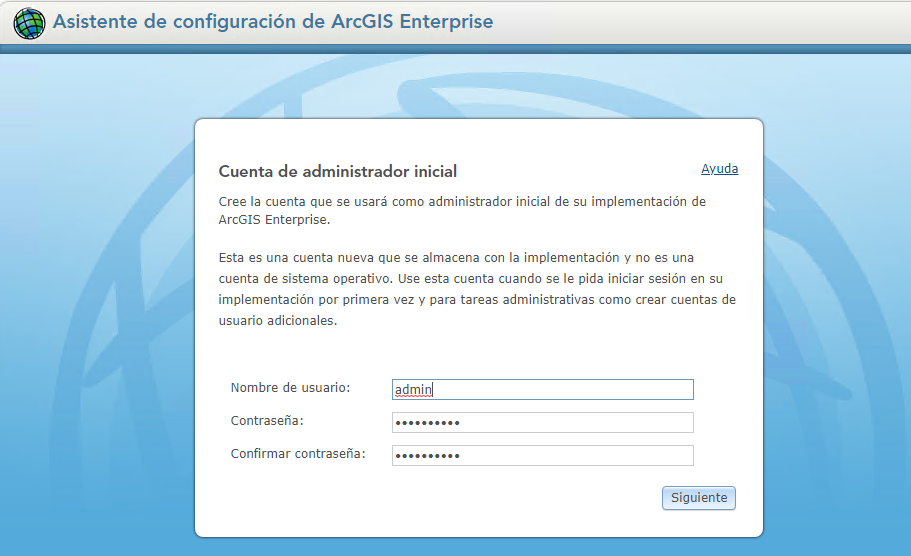

The error is about privileges and accounts, which I enter in step 1, but I have no options to enter a user type, which I assume is the error I have. In the following image where it says "User Type" is blank.
in the initial step of the wizard I have nowhere to enter the type, only user and passwords
I have read about installing by commands instead of this wizard, but I don't know how to do it, do any of you have any guides, or is there anyone who knows about this problem?
By the way I mention that I can enter my portal and arcgis server separately, but I have not been able to complete this wizard to finish integrating the installation.
