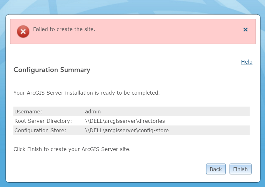

Teejay
I deleted all *.rlock files in C:\arcgisserver and clicked finish in ArcGIS Server Manager, it gave the following screenshot.
