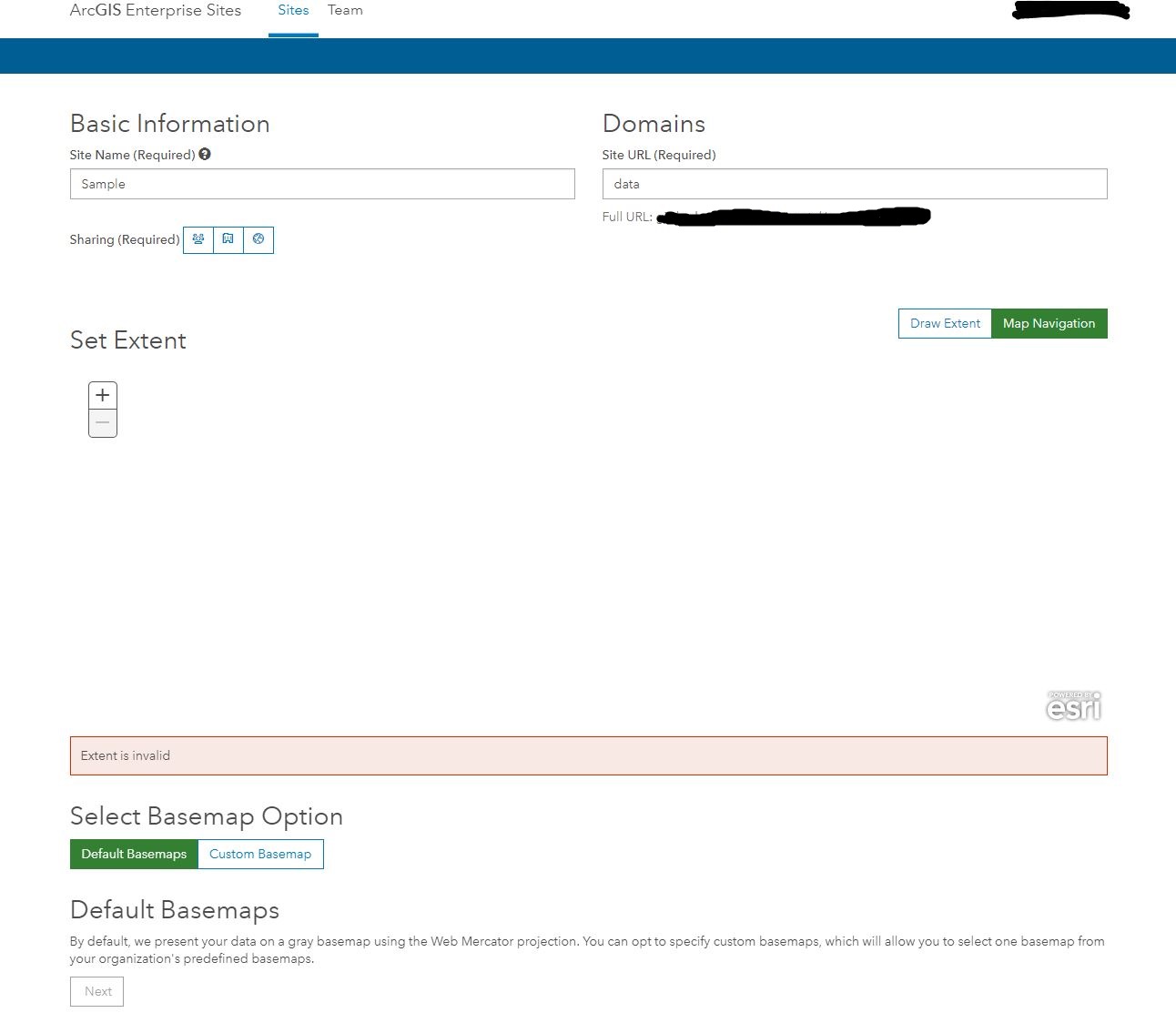

Hello, I am trying to get my organization set up with ArcGIS Enterprise Sites. When I try to get started creating a new Site, I cannot get past this error. I have duplicated this issue in multiple browsers and am unsure how to proceed so I can starting developing Sites. Any suggestions on how to get the map to populate so I can set the extent?

I found a solution to this. I discovered that only Portal administrator accounts were able to create sites, even if non-administrators were in the sites administrators group.
It turns out that the geometry service item in Portal was not shared with the organization. Once I shared it, it resolved the error message posted above.

It seems to be you taken incorrect URL to add data that means url service level or layer lever of REST end point are not consistance, Could you please check service/layer url end point.

Thank you for your response. I was under the impression that the "Site URL" input was just for the user creating the site to define the end of the URL that would be used to distribute the ESRI Site after it was created. Am I supposed to link to a specific layer or map in that box instead?

The geometry service from your federated server contains an invalid character which is being blocked by IIS. In a QA environment, try adding the invalidcharacter tag in the web.config and remove the reference to &amp.
<httpRuntime requestPathInvalidCharacters="<list of default characters>"/>
Removing &amp resolved this issue in my environment, I will likely raise this with Esri as a bug because it seems that the token is being passed through in the URL and it is not handled correctly. Characters, such as &, in the token were causing the geometry service to fail.

This appears to be limited to a specific user. Other accounts within the same Portal are able to access and create sites, just not this particular user. The user is a publisher and has been added to the sites administration group.
DrewDowling
I'm having the same problem but don't know how to fix it. I tried to create a SITE using an account in the Administrators group but get the same error as you got. I have a geometry service added to the Portal using the Portal Utility Services tab in Organization settings. This service is unsecured. I don't see any way of sharing it.
