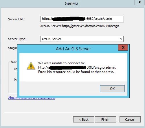

All,
  not really how i wanted to start my weekend, see below...
so all my arcsocs are still running in the task manager, but i cannot connect to that server in arcmap nor can i access the manager website. this happened out of nowhere, i have no explanation for this...which seems to be the growing theme for most our issues with ESRI.
can anyone help or any input on the matter?
thanks
Dave

If you opened ArcGIS Server Manager on the machine where ArcGIS Server is installed, are you able to reach it successfully?  Can you also reach the Admin API on the machine as well?
DaveTenney
So the server instance has been setup and running for almost 2years with only the usual issues...
1) we installed the ESRI 2016 security patch
   a) found that the patch was doing more harm than good
   b) removed the patch
2) Cannot access the saved gis server connection in desktop
3) Cannot create new connection to gis server
3) Cannot access the Manager site for the instance of serve
3) We CAN however access the admin site for the instance of server
   not sure if this was caused due to the removal of the patch or something else.
Dave
