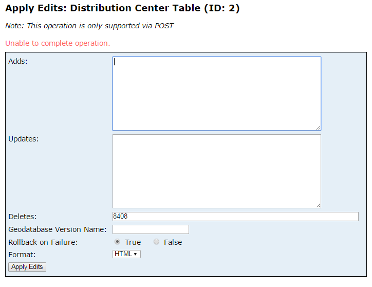

I have a feature service that has one polyline feature class and two non-spatial tables. The problem I met is that the applyedits (add/update/delete) operations fail randomly. it gives me "Unable to complete operation" error msg. I mean sometimes it works but sometimes it fails.
For example, I want to delete a record whose ObjectID is 8408 like the screenshot below. First time I clicked "Apply Edits", it gave me the error msg, but when I kept clicking the Apply Edits button, it succeeded the third time or fourth time. It depends. The same situation happens for my adds operation.

The Server logs should give you an indication of what's failing.  Set the logs to Debug, try your workflow again, and then query at Warning on down to Debug until you get some information on why it failed.  If you're going through a web adaptor or reverse proxy, try the edit through 6443 or 6080.
