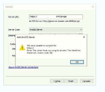

Hi,
I have configured it on a machine or portal and arcgis for server, I am using the standard certificate, which is installed along with the application. I am trying to make publications on others machines within my own domain, but timeout errors are occurring. What could be happening?
Thank´s

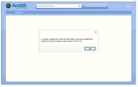

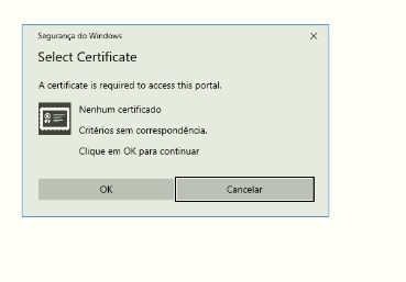

On the second screenshot, it looks like you are canceling the prompt.  If so, the software will refuse to continue making a connection to the server.
SoratoSouza_e_Silva
I'm clicking OK. The first screenshot appear after.

Using something like Test-NetConnection to confirm you can access the machine and port outside of ArcGIS applications.  It may be a firewall or some other network issue is preventing your client from connecting.
SoratoSouza_e_Silva
connects successfully,
but this problem started to occur after federating server with portal
