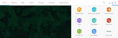

You shouldn't need to install anything. Are you using the app icon from the menu in your Portal?
Happy mapping,
- Zach
GrantSmith122
That's where I initially thought it would be, but it doesn't show up in app gallery when I expand it. Do I need to add it in somehow?

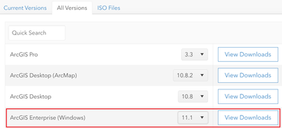

You have to go to my.esri.com and download Survey123 from there.  Then you have to install that application on your Portal machine or a dedicated Survey123 machine.  Once installation is complete, you will be able to access the Survey123 webpage connected to your Enterprise.  I am working on this currently and had to change my URL to https://survey123.domain.org:5443/surveys to get it to let me login.  Now I'm  trying to figure out how to change the URL on my Survey123 shortcut.
Here's a link to a technical document on the installation https://doc.arcgis.com/en/survey123/get-started/installsurvey123.htm#ESRI_SECTION1_7D61157E8220443DB...
Since I had issues finding the app download, I'll give you the location.  The Survey123 application can be found by going into Enterprise 11.2 on my.esri.com, then switching the versions to what you are using.  See pic below.
You then have to scroll down to the Apps category and it's the last item.
Hope that helps!

GrantSmith122
Hey Jasmine, try your portal url. I put in portalUrl=https://myportal.gov/portal and I was able to get in with no problem. There's a banner across the top that displays your Portal URL as well so you can confirm you're in the right place.
Thanks for this Michael!! Working great now
