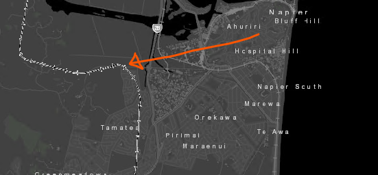

My client has a Map Image Layer Published at 2.6 into 10.9.1 that has been upgraded into 11.1.  It was working fine before upgrade.  Post upgrade, the data is drawing but not in the same place that it was before.
As you pan and zoom around the WMS layers move in relation to the base map.  The image below shows a legacy tile map, which is from a trusted source used by many in the New Zealand community.  It is tried and trusted.  The green highlight shows the location of the railway line (from the base map), the red is the WMS version:
Panning and zooming then moves the WMS version of the railway line to the west:

Hi Scott,
 Please apply WMS Services Display patch posted at ArcGIS Server 11.1 WMS Services Display Patch (esri.com) .

Thank you.  I'm sure that wasn't available when we were testing, so thanks for pointing it out so quickly.  Applied to development and having the desired effect.   Thanks again.
