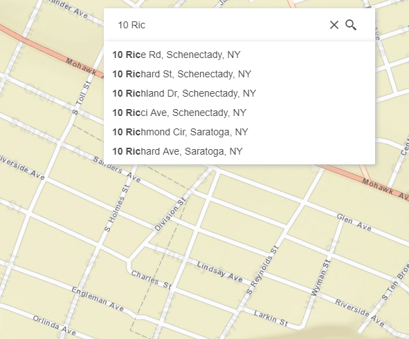

I have a problem about suggestions of Geocoding Service. If I enter an address within the search bar of one of our apps built with WAB, the address will show in the suggestions, then if I click a suggestion, map would zoom to this locate and shown this location, but some suggestions are not.
I don't know what caused this, why some suggestions are invalid?

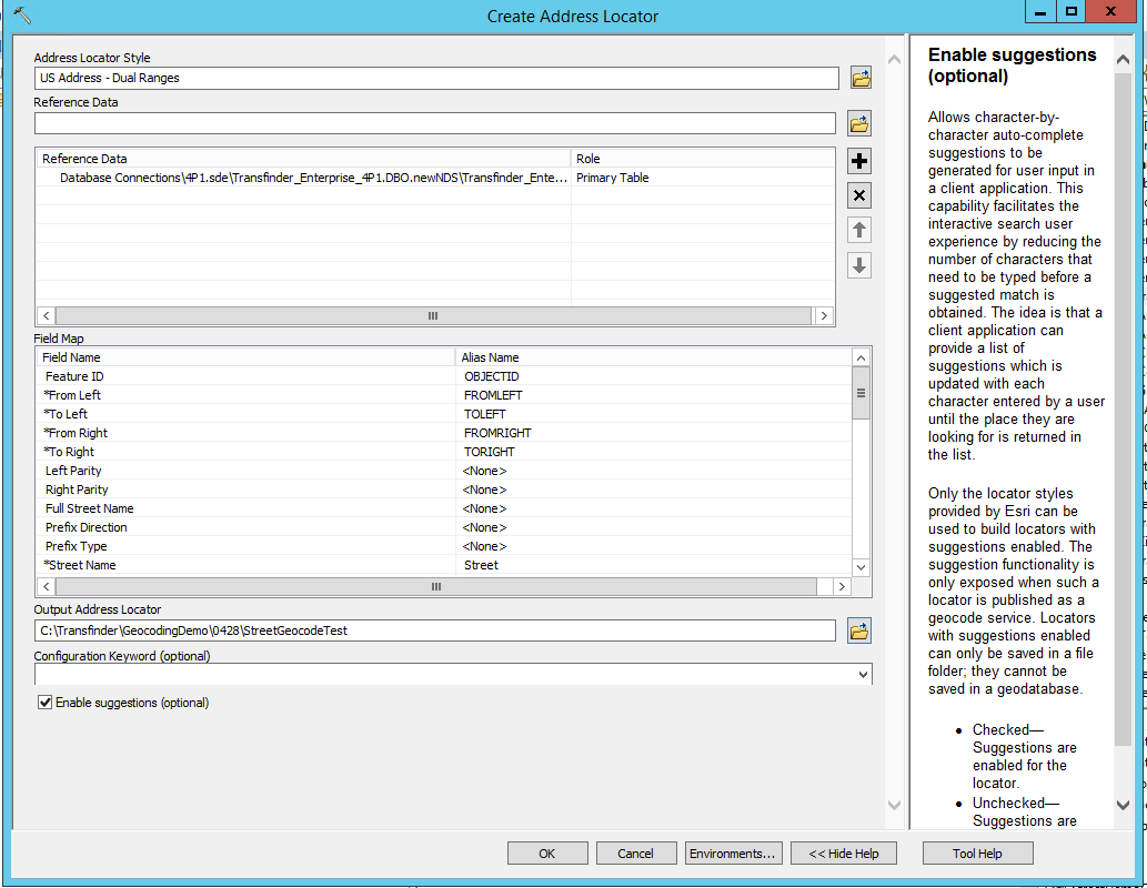

1. Create an address locator.

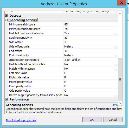

2. Geocoding options for the address locator.
3. Search for 10 Ric, six suggestions in box.

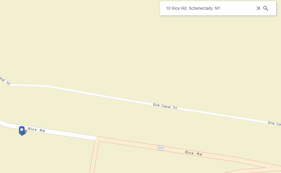

4.  Search result when I click suggestion 10 Rice Rd, it can be shown the location.

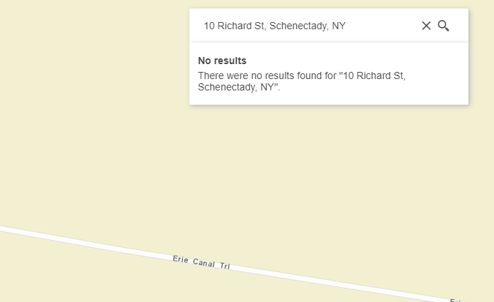

5. Search result when I click suggestion 10 Richard St, it invalid.
