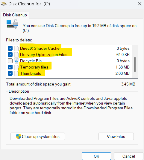

As part of our troubleshooting efforts, we observed a significant improvement in response time after clearing the following items on the deployed VMs using the Disk Cleanup utility. A snapshot for the same is given below for your reference:
Thumbnails, Temporary files, DirectX cache, Delivery optimization files
Could you please assist us in resolving the issue.
