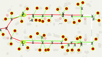

Thank you very much, I'm running into another issue that is somewhat related to the discussion. To start, here is an example of the custom symbology shown for the ArcGIS Pro project I am using to deploy to enterprise.

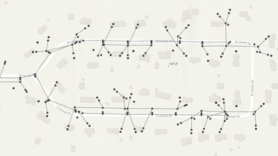

If I go into my portal and open the feature service layer that was just created during publishing in ArcGIS Pro, I get the following:
Now if I share as a Web Map instead of a Web Layer, and open the associated feature service layer to the Web Map deployment, the custom symbology loads and appears as the first picture. Why does sharing as a web layer downgrade all the symbology to a grey mess for the feature service layer but does not for the web map's feature service layer?
