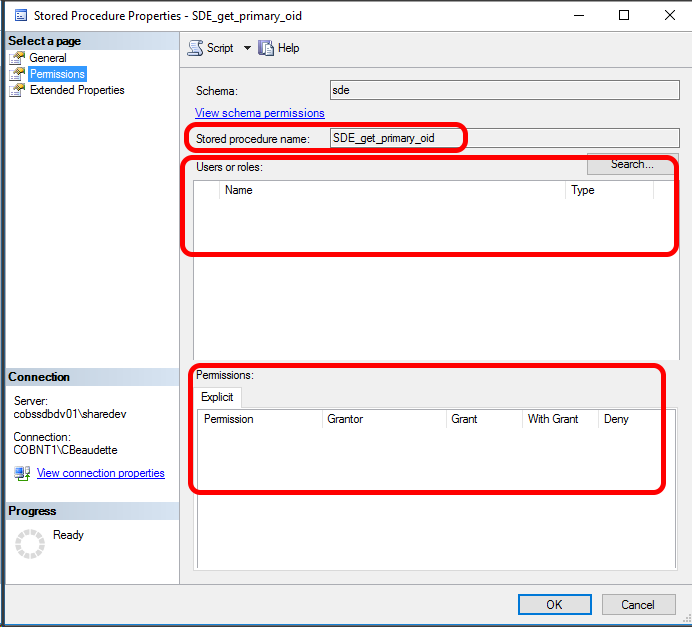

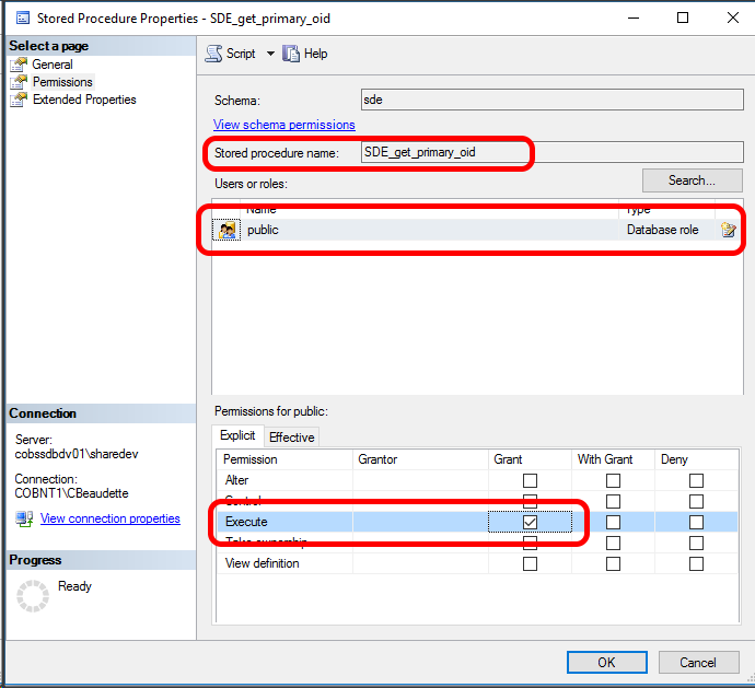

I was able to publish to other geodatabases in the same instance.  I did a SQL Profiler trace on the failed publish and found the following error:
The EXECUTE permission was denied on the object 'SDE_get_primary_oid', database 'DB_NAME', schema 'sde'.
When I compared the SQL Server permissions on that stored procedure, I found that the 'public' db role had no permissions at all in the database where the publish was failing, and 'execute' permissions in the DB where it was succeeding.
Perms on sde.SDE_get_primary_oid in database where publish was failing:
Perms on sde.SDE_get_primary_oid in database where publish was succeeding:
A cursory glance at other stored procedures in the sde schema showed that the SQL 'public' role had execute permissions on all of them, even in the database where the publish was failing.  For some reason, the required permissions were not granted to SDE_get_primary_oid only.  This was unexpected since in both databases I added the same domain user account using the Create Database User tool.
The solution was simply to add execute permissions for the SQL 'public' role on the sde.SDE_get_primary_oid stored procedure.  And, of course, to swizzle my bad self.
