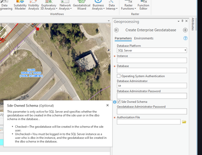

When you use the Create Enterprise Geodatabase tool it will give you the option to either have a user named SDE own the SDE schema, or have dbo own the SDE schema.
 A note here is that you should set up a user other than SDE to actually own data (I.E. Feature Classes, tables, etc.).
