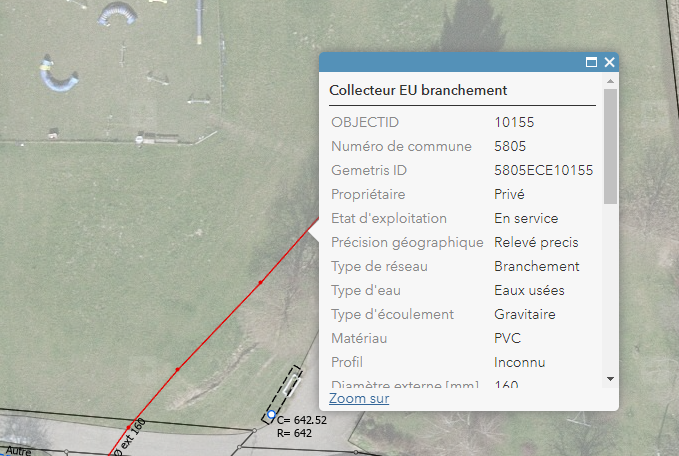

Hello all,
After publishing a series of layers from ArcGIS Pro, we encounter problems with some of the layers on the webmap. When you select them to see the pop-up, the information is well there but the element is not highlighted in blue on the map (see example).
In the map layer this is not the case for all of the layers. We use Enterprise 10.8.1 and the data is stored in postgres. I tried republishing and adding to a new map but it did not solve the problem.
Thank you for any help!
Ana
GeoguichetGeoguichet
For info, I have found that the problem for this was that I put the shape attribute not visible in ArcGIS Pro before publishing.
Activating the 'shape' and republishing solved the problem.
