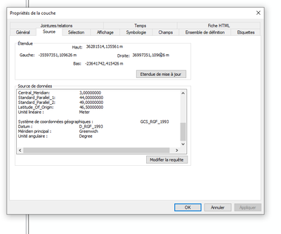

this is what I see, I don't have the usual 'Set datasource...' just 'Update request...'
I've tried to recreate a new mxd and 'Set datasource...' to sde:oracle11g:xyz and I can publish my service but I can't really do that because I have a lot of mxd with symbologies... so I would rather prefer use the original mxd
George_Thompson
Esri Notable Contributor
So it looks like you are trying to publish a query layer.

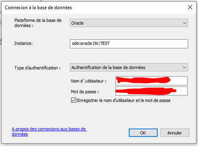

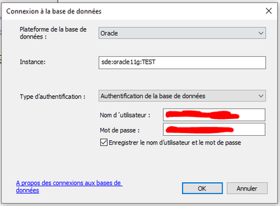

so this SDE is working in ArcCatalog and I can publish it in AGS:
and this one is working on ArcCatalog but cannot be published in AGS (same login/password):
George_Thompson
OK, thanks. This may need a little more detailed troubleshooting and would recommend technical support to work with you on this.
