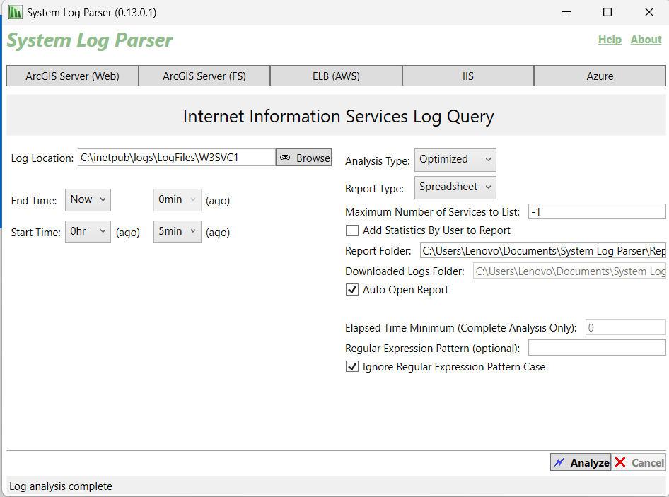

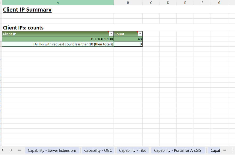

I know it might be late may be someone need it. I think System Log Parser can be handy in this situation as you can configure it with a narrow window of time. The output sheet contains the Client IP addresses that hit the web server. I think this could narrow the search to specific IP addresses. Attached is screen shots from the Parser and the Excel sheet. I hope this might help
