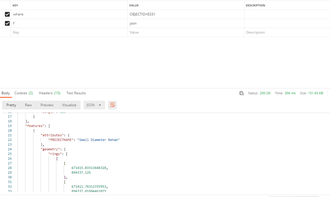

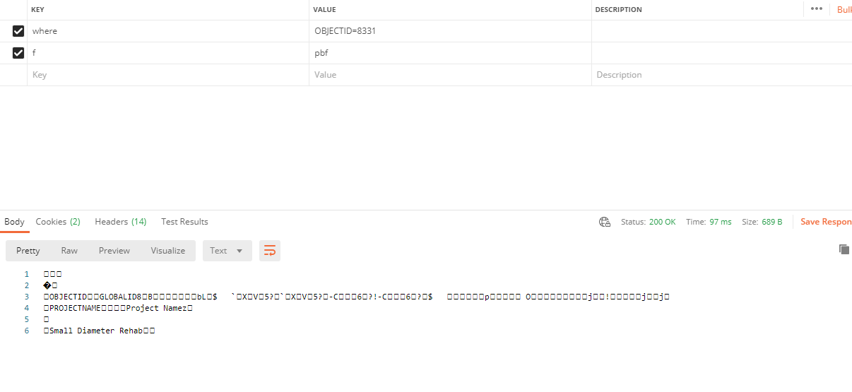

Enterprise 10.7.1 query doesn't return any geometry if the polygon is complex (very many vertices.) This occurs when requesting f=pbf. But, of course, featurelayer defaults to pbf these days. How can we fix/work around this

Can you elaborate on "very many vertices"?  And, did this work in previous versions of ArcGIS Enterprise?  Also, does it work if you change the output format?

yes, work from earlier version
yes, work with f=json/xml

can you share either a polygon that has the issue or create a sample/example that shows the same issue?
