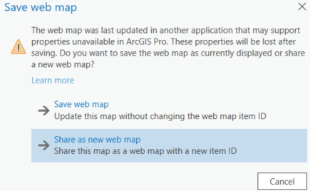

Hi all,
I have been trying to save a new version of a web map to ArcGIS Enterprise. However, the "Analyze" step takes over an hour to complete. How can the analyze step be sped up?
To save this new web map, I have been using ArcGIS Pro's "Save Web Map" feature:
The analyze step is activated once the Analyze button is clicked:

Hi @ANH,
Which version of Pro are you using? There's a suggested version of Pro for each version of Enterprise - here's the link which describes this: https://pro.arcgis.com/en/pro-app/latest/help/analysis/geoprocessing/share-analysis/geoprocessing-se...
The warning you get before saving indicates there's something not right with the ArcPro project - the analyze button essentially scans your whole document for anything that may be incompatible for publication.
Does the document contain many layers? I'd suggest resaving/recreating the document in the correct version of Pro and trying again.

ANH
Hi @A_Wyn_Jones,
Thank you for this suggestion - I had no idea that there were suggested ArcGIS Pro / ArcGIS Enterprise pairings. In my case, I downgraded Pro and tried again - the analyse step only took 20mins. There are many layers in this web map, so it seems you are correct about that as well.
Thank you!
