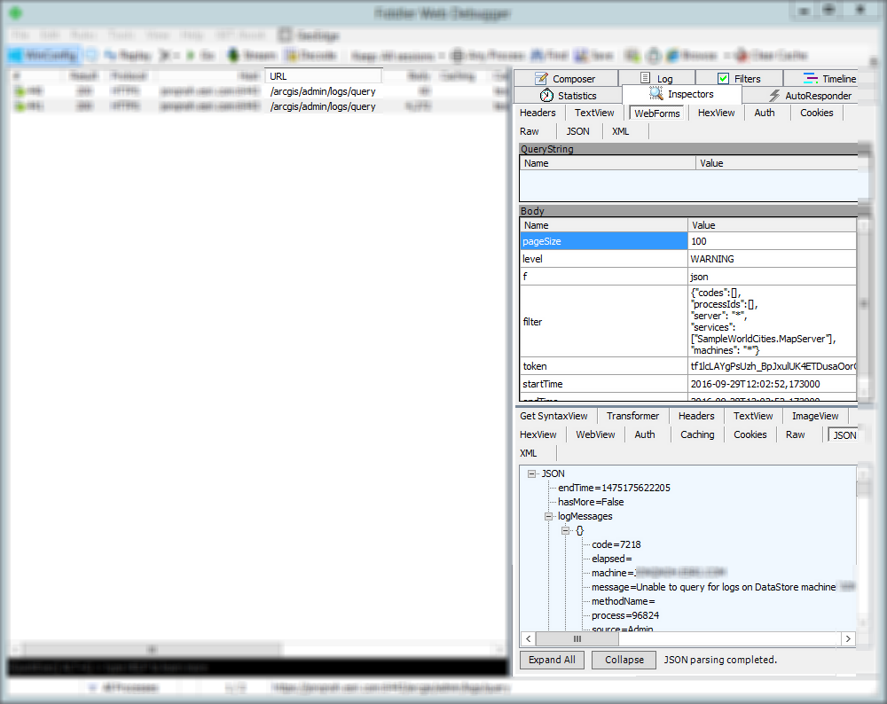

If I submit a request with just the 'services' parameter for the filter, I get no results:
If I include all of the default paramters, I do:
Since you want the results from specific servers, what if you try to include the default parameters for the filter:
{"codes":[],
"processIds":[],
"server": "*",
"services": ["SampleWorldCities.MapServer"],
"machines": "*"}
But pass in the server name for the "server" value through the for loop.  I'm not sure why errors unrelated to SampleWorldCities are returning, but that's a separate problem.

JonathanQuinn
Esri Notable Contributor
{"codes":[],
"processIds":[],
"server": "*",
"machines": "*"}
