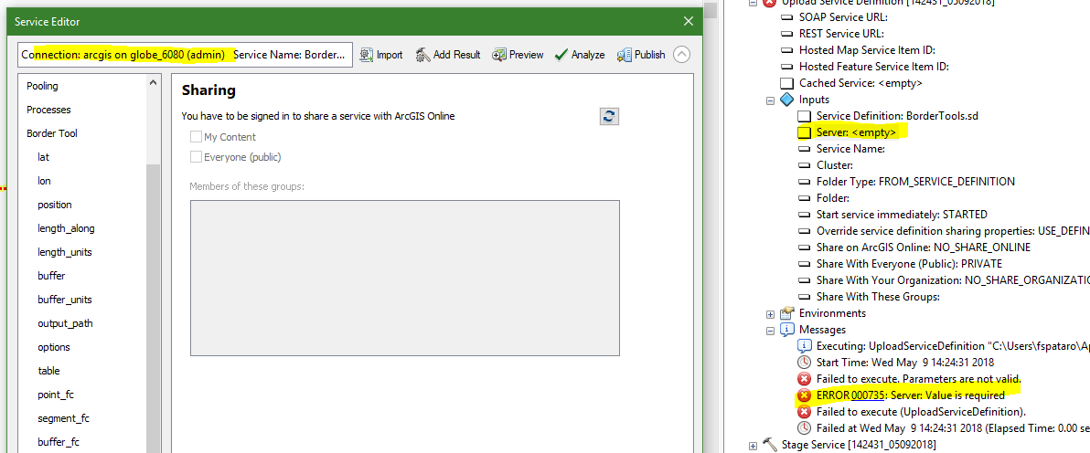

I'm having this issue quite a bit now. I can't publish services from ArcMap.  The failure appears to be the publishing task is not fully populated.  For a while it seemed intermittent, so I've ignored it, but now it's pretty constant.
1. I can access and administer the server via catalog and web manager -- the server seems fine in that regards. I can access services and the rest directory etc...
2. If I save the draft and publish via the web manager, all good.  So again server seems fine and service definition is ok once created.
3. Server logs don't show anything so it doesn't appear to even be getting as far as exchanging any communication with the server.
4. I stooped/started the publishing tools on the server.  Same result.

I ran into this cryptic and misleading error also and found that I was able to successfully publish the service when I did NOT go through the webadaptor (e.g. when I used the https://servername.domain:6443/arcgis url).

Just to keep notes on this... ran into again:
Totally different setup/servers this time:
ArcGIS 10.6 (ArcMap and ArcGIS Enterprise: Server and Portal)
Single machine setup (Server and Portal) / ArcMap on a different workstation
Server federated with portal
HTTPS connection only, using the fully qualified machine name :6443
First time around it fails the same way - GP tool doesn't have the "server" parameter.
Then it won't even get that far and messages about Publishing Tools not available even though they are from the REST and Manager pages and Catalog window.
Restarting the publishing tools and restarting ArcMap don't help
Fixes itself with full shutdown of ArcGIS Server,
ugh.
