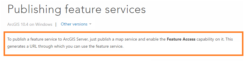

Following ESRI documentation at Here

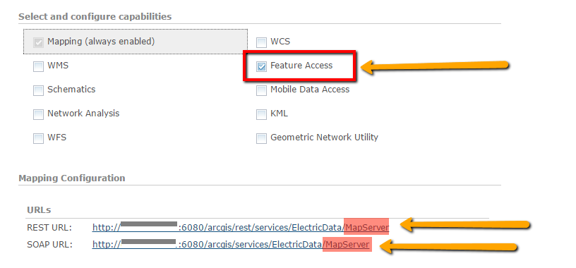

I am trying to publish a Map as Feature Server by enabling the Feature Access on Capability bur when I publish the Map the result looks like

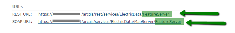

As you can see the URL ends with /MapServer while I need to get a /FeatureServer like
Can you please let me know what I am doing wrong?

If you click on 'Feature Access' in Server Manager you will see the FeatureServer URL.  Also, you can go to your REST Services Directory to obtain this.  Ex:

Thanks for comment Jake, but as you can see in the URL I am not getting any FeatureService but MapServer instead!

Allow me to help clarify Jake's comment. In your 2nd screenshot showing the Select and configure capabilities section, if you click on the Feature Access text (not just check the checkbox, but click on the actual text), this will change what is displayed underneath and you should see a section called Feature Access Configuration - which should show you a REST URL and SOAP URL ending in /FeatureServer.
