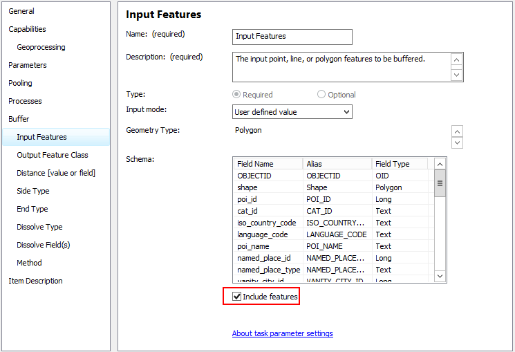

Turn on Info messages and then monitor the traffic using Fiddler or the dev tools in your browser to see the job status:
You can also run it at REST but need the correct syntax for the input feature layer, which you can set as a default through the service editor:
print statements also won't return in script tools or GP services, so you may want to review lines 58-63, (at least in the original script):
