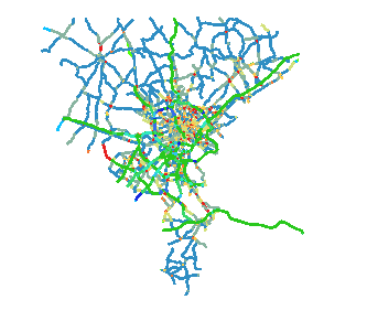

Image of layers (REST javascript preview) zoomed out:

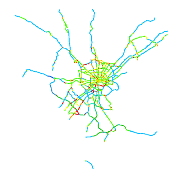

Same service (REST javascript preview) zoomed in 1X:

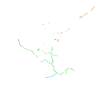

Same service (REST javascript preview) zoomed in 2X:

I see your map service is that one that is not drawing those features on the server side. Even when I add a layer as a feature layer (to draw features on client side), I see the same issue - that means the issue affecting mapservice's export and query operations.
Which makes me think whether there were some issues with the FeatureClass' spatial index. Would you mind try rebuilding the FeatureClass' spatial index. Also try running Check Geometry and Repair Geometry gp tools.
