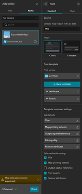

I am trying to use a custom print layout in Experience Builder for an application we are building for some of our end users to export their own maps of properties in our municipality. I was working through some other guides online for exporting an "ExportWebMap" tool with a shared layout file that I created. However all of these next steps involve publishing the print service using what I've done to a standalone server via the catalog pane in Pro. This doesn't match up to what I see on my catalog pane where the guides say "In the Catalog pane, right-click the server connection and choose Publish". I don't see where I can publish to my Enterprise portal in catalog.

I've done this, I see it as a utility to add but it says "This utility service is not supported". I will try to re-export again, I've followed that same documentation that you sent and my ArcGIS Pro is up to date along with my Enterprise.

I've set it to sync when I created the ExportWebMap, I followed the documentation to re-export the service to Enterprise sent by A_Wyn_Jones above, but now I am running into issues with my version of Pro and Enterprise as I just updated my ArcGIS Pro but I suppose now it's out of sync with the version of Enterprise our organization is running so I'm at a standstill until we get our Enterprise also updated.
I am hopeful that it will work this time though, thank you for your help.
