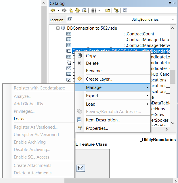

When right-clicking a feature class in an ArcSDE geodatabase from ArcGIS Desktop, the 'Privileges', ‘Register As Version’ commands are grayed out even though the user is connected as the data owner, and (Advanced) ArcGIS Desktop license is being used.
In my case the data owner is the ‘SDE’ user, I restored this database from the backup to a new SQL server instance on a test machine, The SDE user is able to connect to the database and view the feature classes, now I am trying to assign privileges to users and register the feature classes as versioned and I found out that the Privileges, Register as Version commands are grayed out!
I made sure that I am using the SDE user who owns the data and an Advanced license of ArcMAP 10.5.0 https://support.esri.com/en/technical-article/000009946

You might have granted the SYSADMIN server role to the SDE login, which will make it a DBO schema user and thus those options will be grayed out.
Just as a quick test, you can try creating a simple table or a feature class, connected as the SDE login and check the Data Owner schema.

Asrujit, You Are A Hero!
I have granted the SYSADMIN server role to the SDE login, I thought this would be better, more permissions means more power to the user ! which is not.
After removing the sysadmin role everything back to normal.
