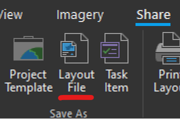

Make sure the layouts/templates you have prepared in ArcGIS Pro are exported as layout files:
Once you have a selection of templates in a folder, you can follow the documentation from this point onwards: https://enterprise.arcgis.com/en/server/10.9.1/publish-services/windows/tutorial-publish-additional-...
"We've boosted the Anti-Mass Spectrometer to 105 percent. Bit of a gamble, but we need the extra resolution."
KSmyth4
Thanks @A_Wyn_Jones for this help, much appreciated, we have the templates all created now as Layout Files and are working our way through the documentation you have provided.
