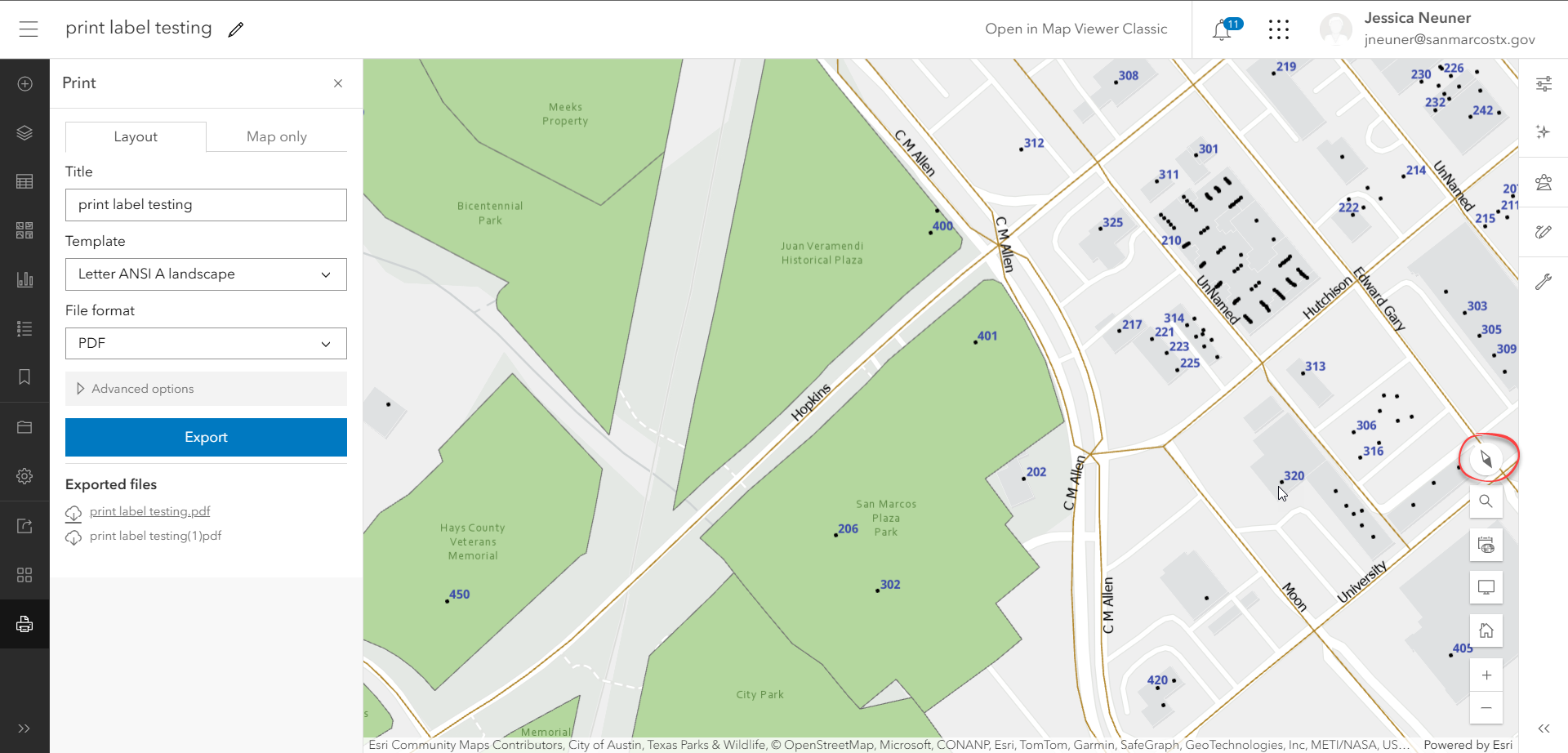

  • when the map is rotated -- those labels look great in the web map. they rotate just fine
  • BUT - once the map is printed, they might be upside down
Here's a simple example of my rotated web map -- labels looking as expected --

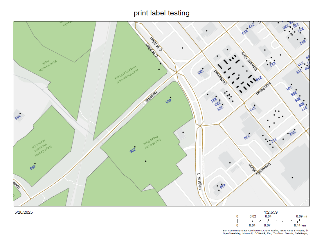

and the output pdf from the print request, everything is upside down.

Out of curiosity, brought the map service into Pro to see what happened if I rotated the map frame... and the labels didn't right themselves, they were upside down.
Not quite sure why they are right side up in a web map, but not in Pro.  Incidentally I brought the web map from the original test into Pro -- and same thing, the labels were upside down.  Still a little puzzled, but does seem like a limitation of the map server?
