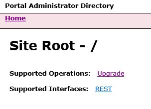

Hitting upgrade on the standby machine shows this message (domain.com covers our actual domain):
"Upgrade failed. You can only upgrade the primary portal machine domain.com when portal is in a highly available configuration."
