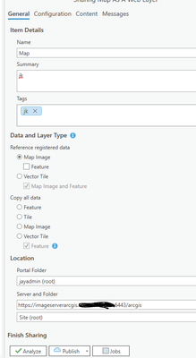

We recently installed and authorized Image Server role as a standalone server.  It is not part of a multi-machine deployment with our existing Server / Portal ArcGIS Enterprise.  We did add it as a Federated server to our Portal though.
When I use Pro to try and share a web layer to Image Server, I get the error "the ArcGIS GIS server role is not licensed on the ArcGIS Server". If I go to Server Manager on the image server, it does say the image server role is licensed correctly.  If I go to Server Manager on my regular ArcGIS Server, it is of course not listed as an available extension because I did not configure it as part of a multi machine deployment.  Am I doing something wrong?  Does image server need to be part of a multi-machine deployment with our existing ArcGIS Server? Or for this to work would I need to set up a separate Portal and federate that with Image Server?  Unclear what the architecture should be here....

You need to right click the Mosaic Dataset and share. Look at this workflow: https://pro.arcgis.com/en/pro-app/latest/help/sharing/overview/publish-an-image-service.htm
I have done this many times.

A Map Image layer is not the same as an Imagery layer. Map Image layers are published to a GIS Server, and traditionally reference data within an Enterprise Geodatabase / file geodatabase (vector data). An Imagery layer is a published mosaic / Ortho Photos layer, and those can only be published to an Image Server.
