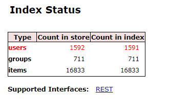

Recently upgraded to 11.4 and our Portal index for users is out of sync.  The group and item indexes are fine.
1. Tried rebooting
2. Tried reindexing and reconfiguring
Any ideas?? all suggestions are welcome!!
Dan
Error reindexing 'USER_MODE'. java.lang.RuntimeException: java.lang.Exception: The server at 'https://xyzxyz.xyzxy.NET:7443/arcgis/sharing/rest/config/indexer/reindex' returned an error. Error running reindex operation. ["java.util.concurrent.ExecutionException: java.lang.NullPointerException: Cannot invoke \"com.esri.gw.data.GWUser.getUsername()\" because \"<local4>\" is null"].

Running into this issue as well. Recently upgraded to 11.4 and noticed the index difference. Index has our count off by one. Running reindex with user mode does not appear to index anything. Portal log has no information about trying to run the index.
TimSwalin
Changed log level to debug. received an error. When deleting it states the index does not exist, when creating it states the index already exists.
