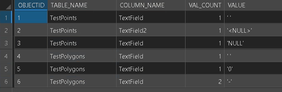

JohannesLindner
MVP Alum
def check_for_junk_values(layer_or_table):
    fields = [f.name for f in  arcpy.ListFields(layer_or_table)]
    junk_values = [0, " ", "  ", "-", "0", "NULL", "<NULL>", "<Null>"]
    data = [dict(zip(fields, row)) for row in arcpy.da.SearchCursor(layer_or_table, fields)]  # [{"Field1": 0, "Field2": 1}, {"Field1": 5, "Field2": 2}]

tables = ["TestPoints", "TestLines", "TestPolygons", "TestTable"]
# you can also use paths to your tables, or list them automatically with arcpy.ListTables() / arcpy.ListFeatureclasses()
log_table = arcpy.management.CreateTable("memory", "JunkLogTable")
arcpy.management.AddField(log_table, "TABLE_NAME", "TEXT")
arcpy.management.AddField(log_table, "COLUMN_NAME", "TEXT")
arcpy.management.AddField(log_table, "VAL_COUNT", "SHORT")
arcpy.management.AddField(log_table, "VALUE", "TEXT")
with arcpy.da.InsertCursor(log_table, ["TABLE_NAME", "COLUMN_NAME", "VALUE", "VAL_COUNT"]) as cursor:
    for table in tables:
        result = check_for_junk_values(table)
        for key, count in result.items():
            col = key[0]
            val = key[1].__repr__()  # __repr__() to get the quotes
            cursor.insertRow([table, col, val, count])

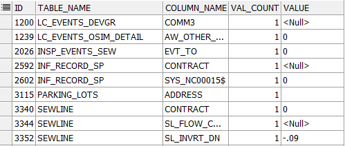

It's possible to do this with PL/SQL.
--DROP TABLE incorrect_value_results;
--CREATE TABLE incorrect_value_results (id NUMBER, table_name VARCHAR2(30), column_name VARCHAR2(30), val_count NUMBER, value varchar2(30));
TRUNCATE TABLE incorrect_value_results;
DECLARE

Pros:
  • The PL/SQL script's performance is very good. It scans millions of records in less than 10 seconds. And it might be possible to optimize it even further.
Cons:
  • The code is somewhat lengthy. It might be simpler to do it with ArcPy.
I don't need the solution to work for all geodatabase types; I just need to use it on my Oracle enterprise geodatabase. But an ArcPy solution would be more beneficial to a wider audience.
