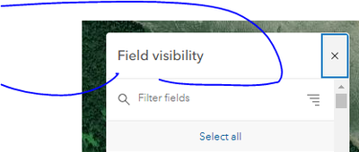

RandyMcGregor3
Thank you. That's good. Also (I just discovered) when you open a table in new map viewer and select the gear, you get an option to control field-visibility. This does control what appears in a dashboard detail panel as well. Separating popups from other table views makes a lot sense.
