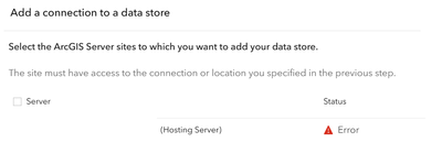

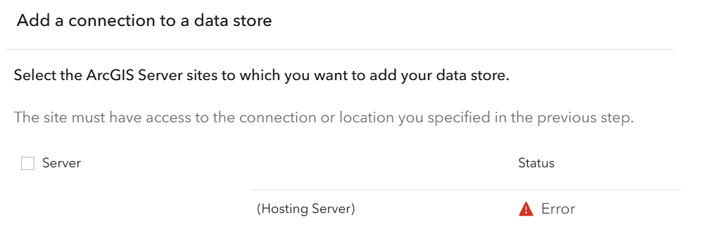

I am getting the following error when trying to create a new Data Store from the Portal. "The site must have access to the connection or location you specified in the previous step."

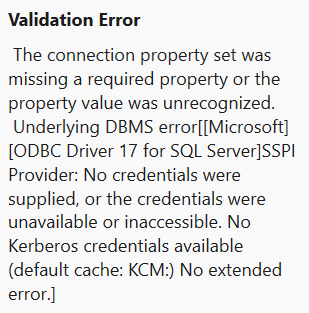

I get a similar error from the ArcGIS Pro client side:
"The connection property set was missing a required property or the property value was unrecognized.  Underlying DBMS error [[Microsoft][ODBC Driver 17 for SQL Server]SSPI Provider: No credentials were supplied, or the credentials were unavailable or inaccessible.  No Kerberos credentials available (default cache: KCM:) No extended error.
The error occurred creating a Data Store with newly issued database connection using Authentication Type: Operating System Authentication (from Windows).
