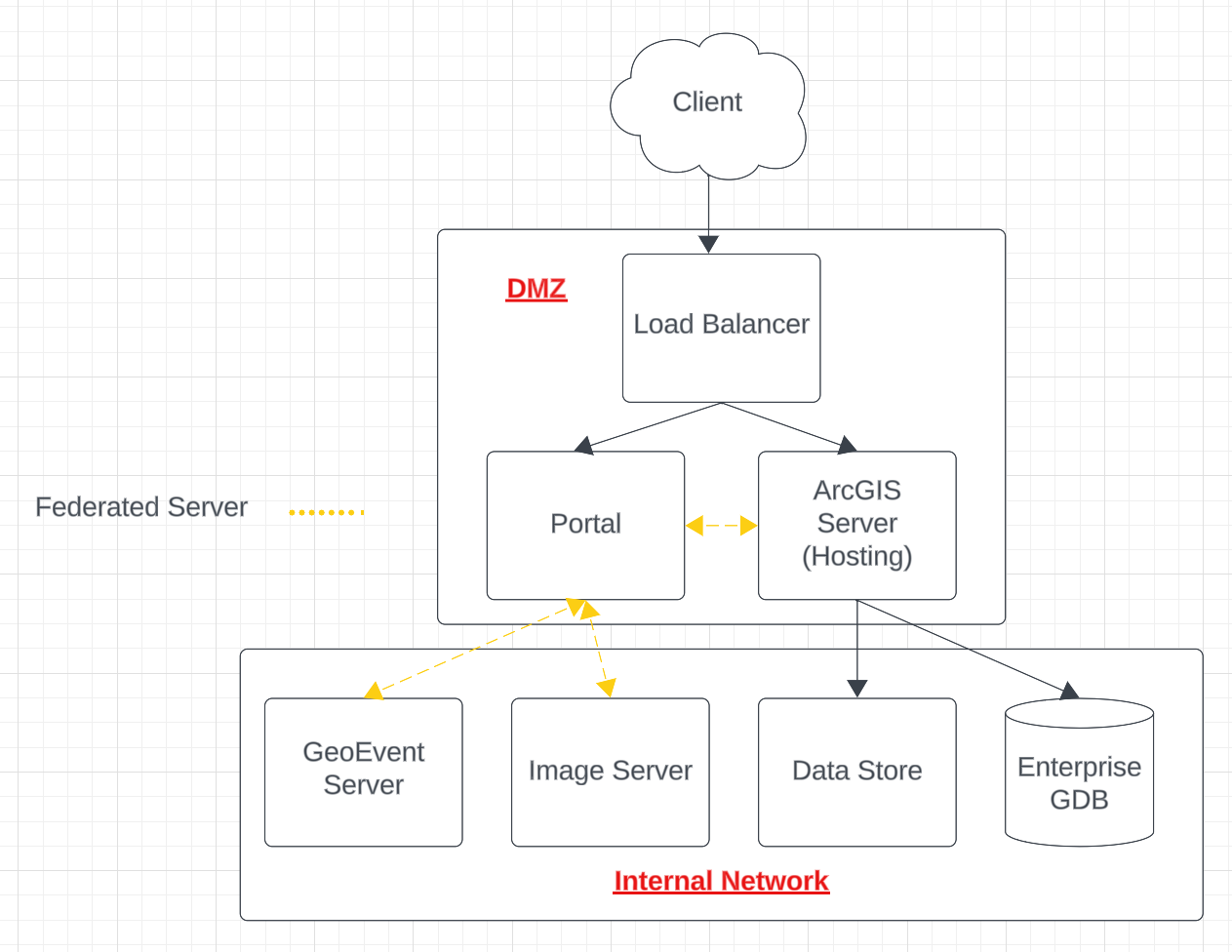

I have to opportunity to re-design our ArcGIS Enterprise deployment and could use a sanity check.
Current state: ArcGIS Enterprise on 11.1, Windows, on prem, no web adaptors, F5 for load balancer, Portal and ArcGIS Server in DMZ (for field work use without VPN), other components in internal network

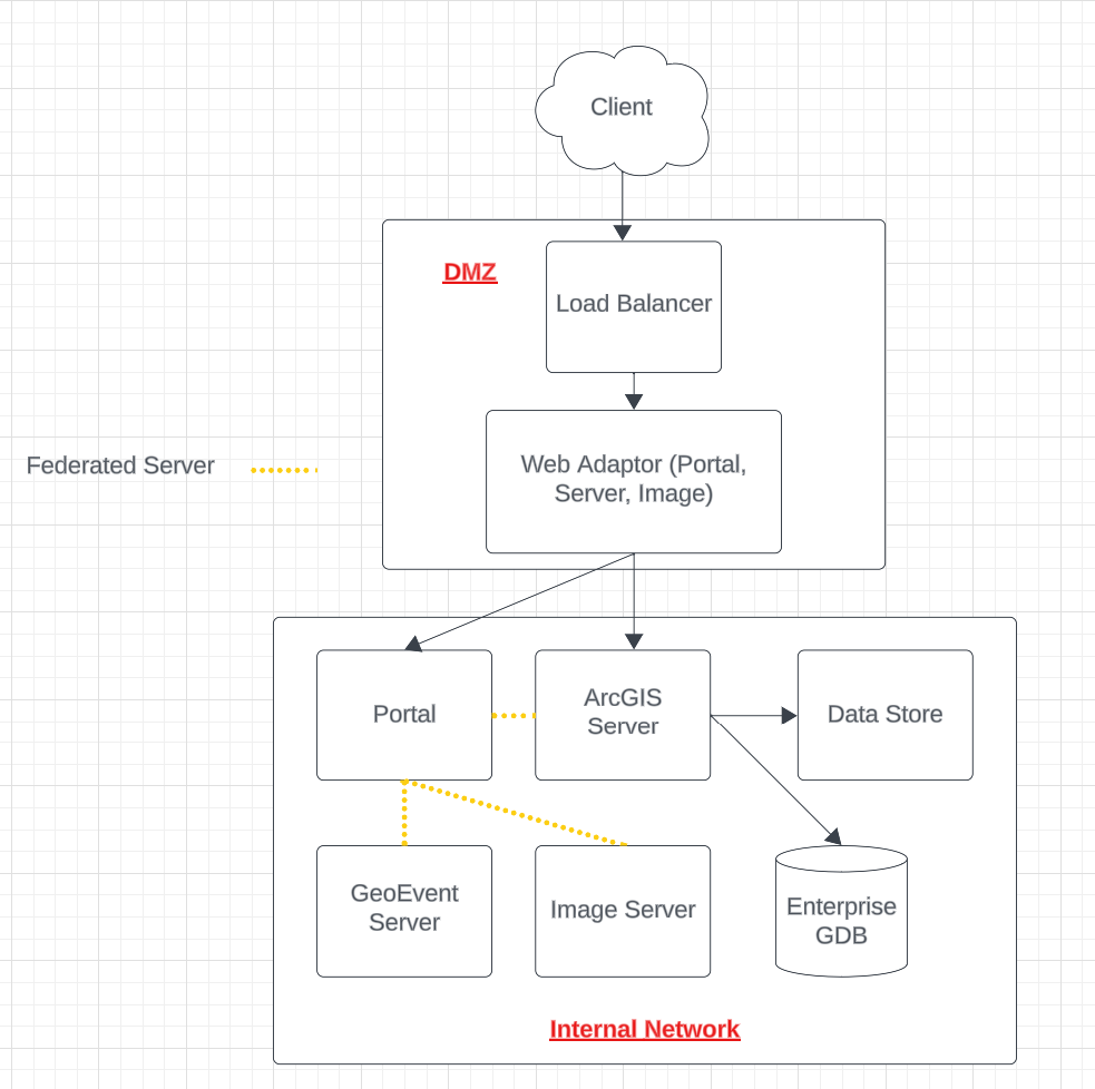

Future state: ArcGIS Enterprise 11.1 windows on prem (no change), new host in DMZ with multiple web adaptors installed, F5 in front of web adaptor host (IT requirement), all AGE components moved to internal network
What I think this should achieve is the ability to still connect to Portal off VPN; traffic would route to F5 > Web Adaptor host > Web Adaptor host routes to appropriate AGE servers within the internal network
We currently use the DNS alias to define routes within F5 (eg. portal.company.com/arcgis, server.company.com/arcgis). Ideally, our F5 config could be simplified by having a single VIP (eg. maps.company.com) which routes to the Web Adaptor host > and we use the URL context to define where traffic goes (map.company.com/portal, maps.company.com/server, maps.company.com/image).
Any gaping holes in this plan? Is the single web adaptor host (with web adaptor for portal, server, image server installed) advisable?

I think you nailed it, nice work!  This is almost exactly what we have done and it works great.  No VPN required and high security.   The only thing we did a little different from your plan is that we created a Virtual server in F5 and assigned our DNS name to it.   That way we can offload SSL to F5, and should we ever need to swap servers, we can do so by simply changing what F5 points to for the web adaptor server.  No problems at all running multiple web adaptors on a single server.
Edit:  I guess we do subdomains differently than you do.   We have one subdomain for the whole system (enterprise.company.com/portal, enterprise.company.com/server, enterprise.company.com/image, etc).   Each component except the data store has its own web adaptor.

Awesome, appreciate the feedback @MichaelJenkins ! Now I can rest easy 😊  Yes, the goal would be to get our subdomains aligned with what you have: enterprise.company.com/*web-adaptor-name*
Right now it's a big mess in F5 (which I have limited visibility into) with multiple VIPs, pools, iRules just for a standard deployment. I'm hoping we can get to state that pretty much emulates yours!
I'm planning to deploy all this with the PowerShell DSC too, so moving things into our internal network should reduce the # of firewall rules I need to implement. Really, I just need to make sure the Web Adaptor host can communicate with the various AGE components on their designated ports right (7443, 6443, the usual)? Being on the internal network should alleviate some of the headaches with the internal communication between Portal, Servers, and Datastore. At least that's what my Friday night brain is thinking.

Can you elaborate on this a little bit? So you have your 'Site/VIP' (enterprise.company.com) in F5 using a CA SSL certificate correct? Do you also configure SSL within IIS for each web adaptor using domain or CA certs? What about the portal/arcgis server machines? @MichaelJenkins
MichaelJenkins
Yes, the F5 Virtual Server has the DNS C-Name assigned to its IP and a CA SSL applied to it.  The web adaptor server runs IIS and can use a domain cert.  The F5 VS is the only thing end users connect to.   It proxies traffic to a 'pool' which, in this case, only has one server in it and that is the web adaptor server.
