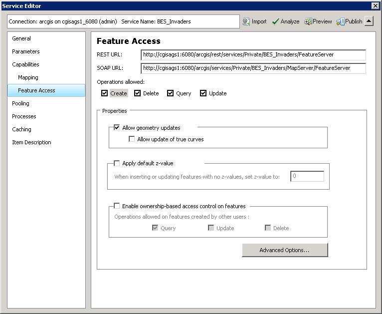

It is an on-premise ArcGIS Server (10.2) editable feature service referencing a polygon feature class in a non-versioned SDE (SQL Server) geodatabase (also v10.2). I have enabled all editing privileges as such:

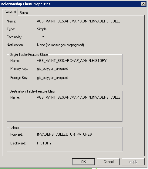

The data is in Web Mercator, with editor tracking, and a relationship class with a 1-M relationship with a non-spatial table. There's no messaging in the relationship class. The project partner just wants users to be able to view the related records but the only edits will be to the spatial data. The properties of the relationship class are:
