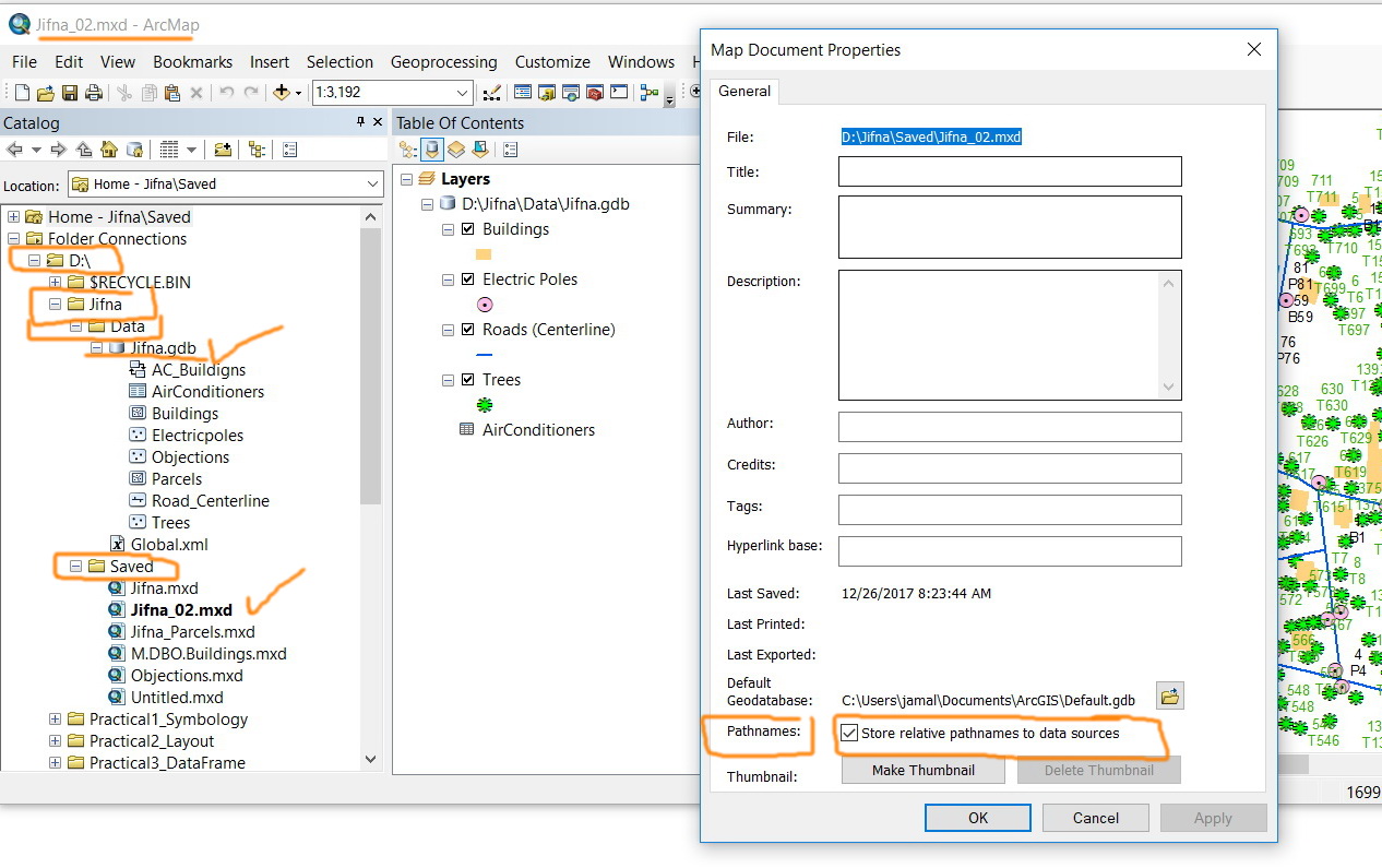

JamalNUMAN
Legendary Contributor
In my perspective, as long as the gdb and mx are contained under the same root, all should work fine.
For example, in the screenshot below, the gdb is saved in Data folder while the mxd is stored in Saved folder. If the root folder (Jifna) is moved from a machine to another having the “pathnames” option checked, then opening the mxd from the target machine should work with no exclamation sign. This proves that this structure is “relative”
Jamal Numan
