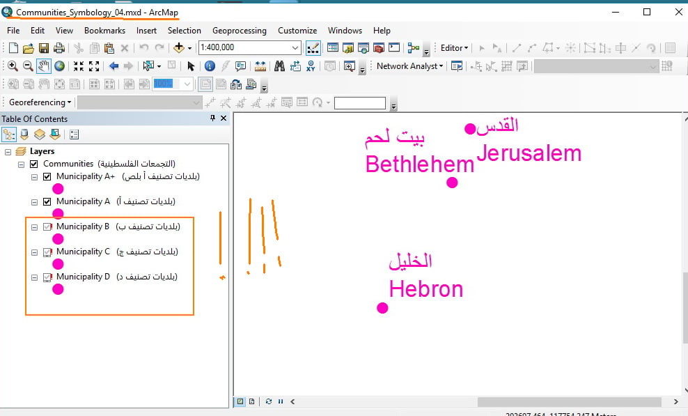

 Despite that the "Store relative pathnames to data sources" is checked, the mxd fails to preserve the data source, and displays the exlamination mark whe(attached)
We tried to save the mxd as a copy and rename it, but the issue presets to exist.
What might be the issue here?

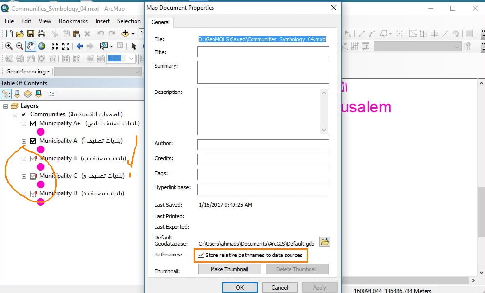

I am setting the correct source and save my mxd file as shown in first screenshot,
And when opening the mxd, I found that it returns to its old status, and fails to save the data source as attached.

Kindly note that I am using store relative pathnames in the project, the screenshots below show the folder structure,
 Please let me know if you want any clarifications.
Best,
Majdoleen
DanPatterson_Retired
MVP Emeritus
the mxd should be in the GeoMOLG folder ie... at the root level of that folder, not within Saved
