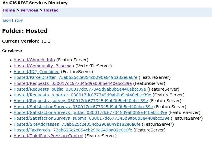

The hosted feature classes still show up in Portal, but trying to access the data results in the message "There was an Error".  There is nothing in the portal log file regarding the hosted feature classes.  All of our hosted feature classes are still listed in the server rest services directory:

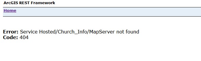

Trying to access any of the FeatureServer's results in an "not found" error.

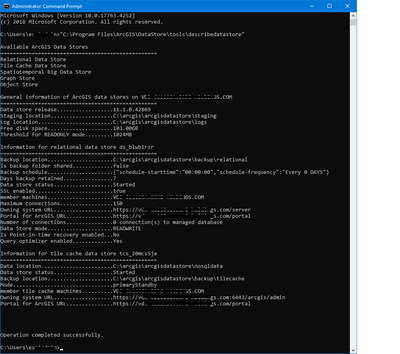

ChrisUnderwood
You could run a check on your Relational Data Store. That might help you to understand if the problem is with the Data Store itself, or somewhere else.
You can run a command like this.
"C:\Program Files\ArcGIS\DataStore\tools\describedatastore"
A healthy ArcGIS Enterprise 11.1 Data Store will return details like this.
drunneals_cgs
404 means file(s) missing, not a database error. The error is showing up because the files don't exist. You need to check that folders exist for this service in [ArcGIS Server System Directory Path]\arcgisinput folder along with [ArcGIS Server Config Store Directory Path]\services folder. I just dealt with this and WebGISDR didn't restore the files correctly. See related post here.
