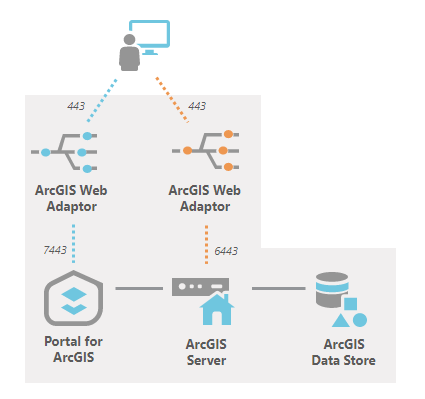

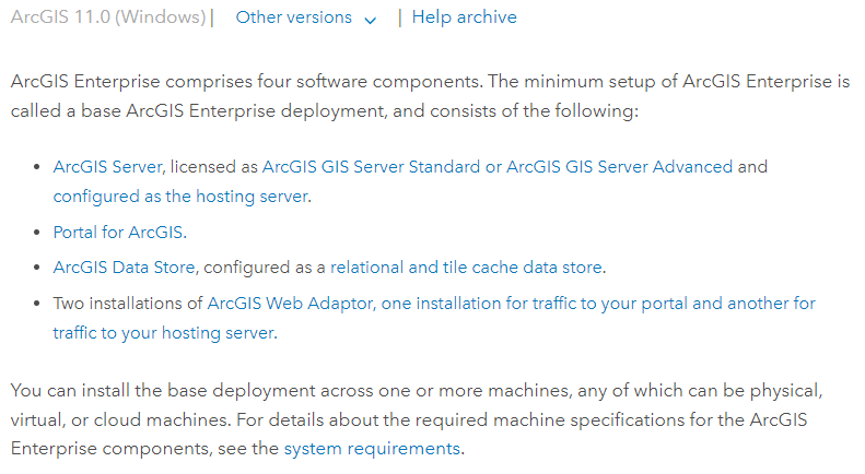

In other words where does the Enterprise Geodatabase belong in the four software components described in ESRIs documentation and schematics?
Or is there another piece of the Enterprise puzzle that is not represented in this schematic?

The diagram you've shown above is the 'Base Deployment' of ArcGIS Enterprise, that is, the minimum spec of an ArcGIS Enterprise you can deploy.  Optional server roles can be appended:
     https://enterprise.arcgis.com/en/get-started/latest/windows/additional-server-deployment.htm
One of those is a GIS Server.  Which is like a hosting server but as this text:
   https://enterprise.arcgis.com/en/get-started/latest/windows/additional-server-deployment.htm#ESRI_SE....
states, it should be considered to be different and 'should' be split out.  It is the GIS Server that connets to any geodatabases.

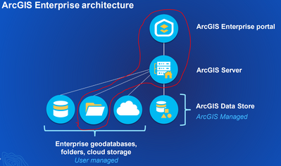

@Scott_Tansley, you mentioned:
I'm on board with that, but I am not grasping the workflow yet.
Presumably, you are referring to this pattern:
And, correct me if I'm wrong, but this pattern is acheived through ArcGIS Pro 'Share Geodata Service'.  I stepped through that process, but in the end, I am not seeing any feature classes within my local gdb from the Portal.  All I see are these two new items in the Portal:
But no clear next step on how to access the gdb feature classes from these items.
Any further guidance would be appreciated.
