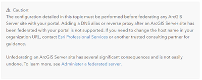

Note:
Integrate your portal with a reverse proxy or load balancer—Portal for ArcGIS | Documentation for Ar...
Caution:
The configuration detailed in this topic must be performed before federating any ArcGIS Server site with your portal. Adding a DNS alias or reverse proxy after an ArcGIS Server site has been federated with your portal is not supported. If you need to change the host name in your organization URL, contact Esri Professional Services or another trusted consulting partner for guidance.
Unfederating an ArcGIS Server site has several significant consequences and is not easily undone. To learn more, see Administer a federated server.
