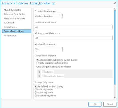

I used the "create locator" GP tool in Pro 2.7 to create a locator. After it was created I modified the geocoding options to allow "match with no zones" and then published the locator to a stand-alone ArcGIS Server (v10.6.1). All that worked fairly well, except I still have to include a zone in the search criteria to get a match. For example, I can't just search "90 W Broad St". I have to search "90 W Broad St, Columbus, OH".

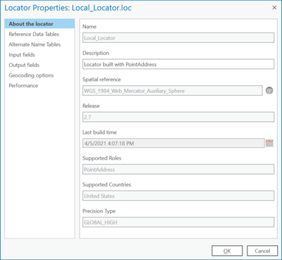

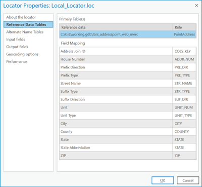

Thanks for the quick reply. I believe the locator is single role. Here are some details about it:
It does seem to work as expected prior to publication. I can add the locator to my Pro project and find addresses without the city, state, or ZIP entered as part of the search criteria.

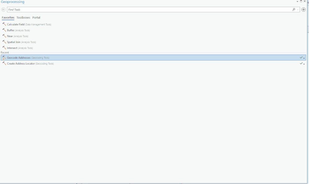

The parameters are what the create locator tool uses.  If you go to your geoprocessing history you can grab the parameters and copy and paste them into a text file.  I do that all the time so I can paste that text in a python script.  See gif below.
