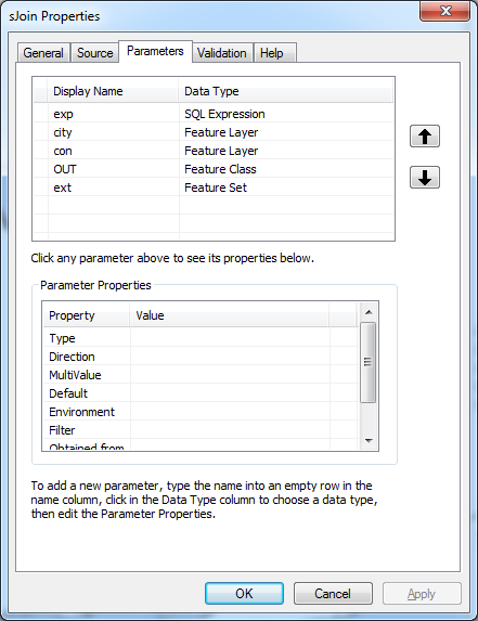

ModyBuchbinder
I tried it and it did not solve the problem (Ask to type in coordinates)
I found a solution that is not ideal but it is working.
See my screen shots.
  1. Define a parameter as feature set (polygon) in the script parameters
  2. In the script – use it for selection:
extentFeat = arcpy.GetParameterAsText(4)
arcpy.MakeFeatureLayer_management(City,
'cities_lyr')
arcpy.SelectLayerByLocation_management
'cities_lyr', 'INTERSECT', extentFeat)
Do buffer on 'cities_lyr'
  1. In WAB I get this as a polygon the user need to enter.
I do not have the option to SameAsDisplay but the user can easily draw a rectangle.
Any better idea?
Thanks
Mody
