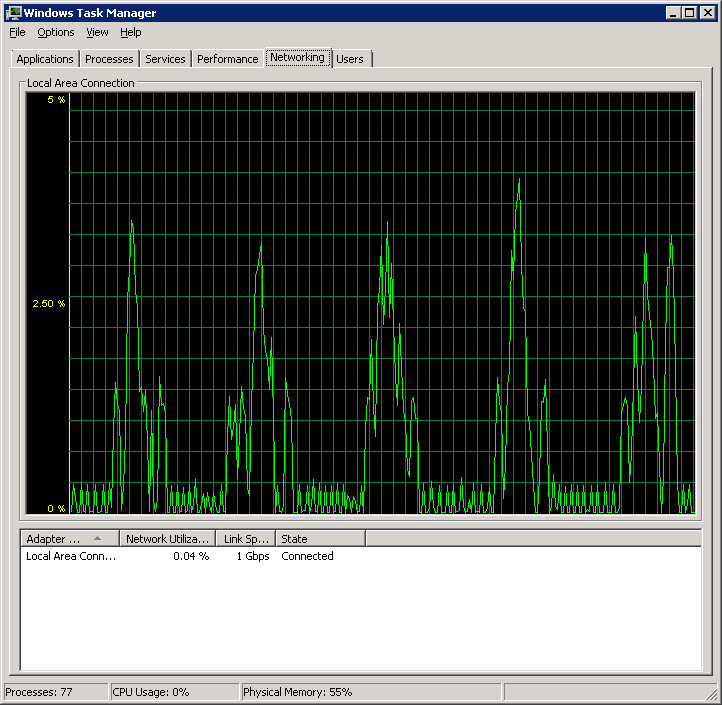

  • The AGS nodes are consistently in communication with the file server (even when the site is idle).  CPU/Memory and Network monitor on that looks like this:
  • AGS nodes look similar.  It seems there is a lot of 'chatter' when sitting idle.
