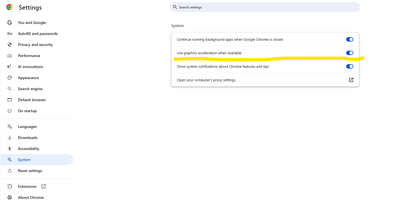

If you are using chrome and seeing this? If you go to the three dots > settings and then click on system, does your machine have graphics acceleration enabled when available?
If its on try disabling it and see if that fixes the issue?
TheRrrr42
Turning hardware acceleration off in Chrome does fix the flickering but results in much poorer performance on the application. We also experienced this flickering inside of Edge and Firefox browsers.

Yes. Same here. Disabling hardware acceleration led to severe performance issues with our webmaps. Also, it didn't seem to totally "fix" the issue for us. Instead of the labels flickering, they would slowly fade in. Some still didn't appear at all. We tried various browsers and had the same results. Since forcing Chrome to use our dedicated GPU instead, we've had no issues and increased overall performance.
