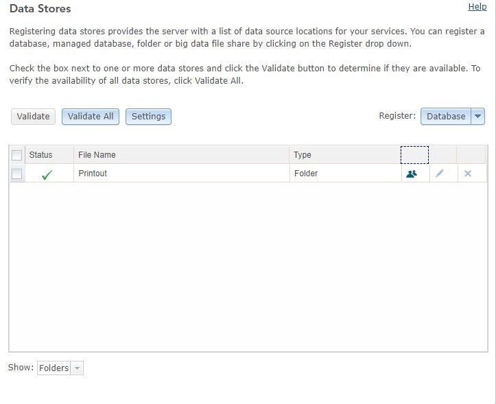

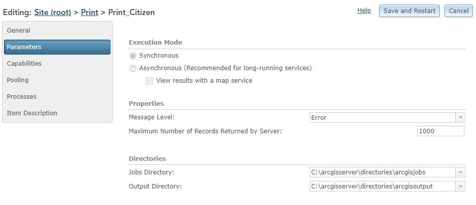

I can confirm that the printing services in our ArcGIS Experience Builder have indeed been configured as synchronous. Additionally, we have ensured that the service account, which is responsible for running ArcGIS Server, has appropriate access to the location where the print templates are stored. This ensures that the print templates are showing up as expected within the application.
