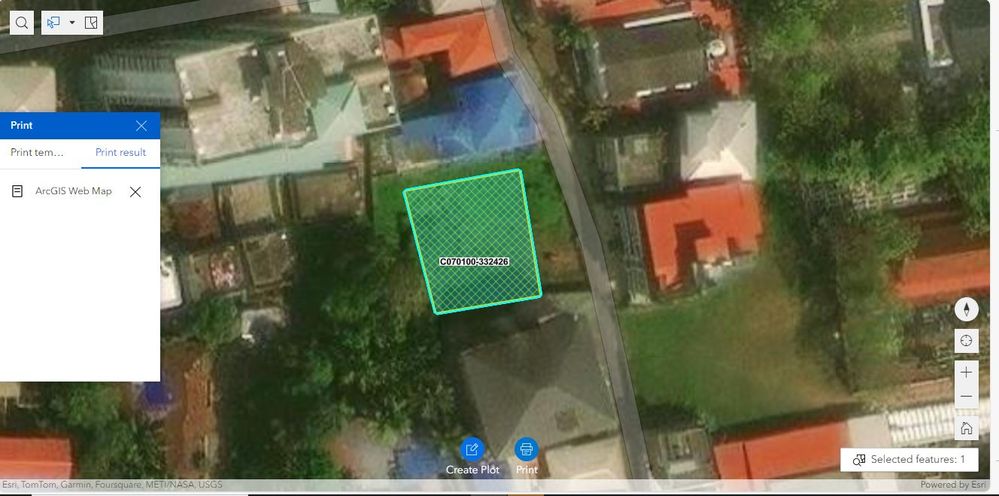

Hello everyone,
I've encountered an issue with a custom printing service setup in ArcGIS Experience Builder in ESRI Enterprise 11.2 and I'm seeking some guidance or insights to resolve it.
Here's the scenario:

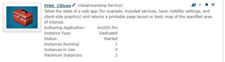

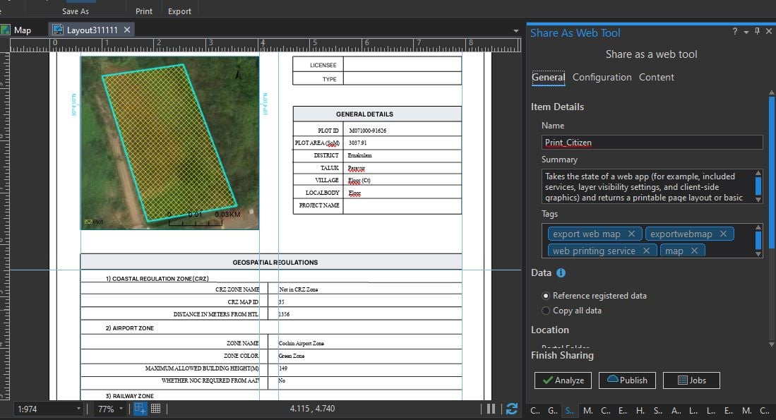

I've created a layout using ArcGIS Pro and saved it in a folder as a .pagx file. Additionally, I've generated Printing Server tools, including Export Web Map and Get Layout Template Info. These tools are then shared as a web tool to the server.
In the sharing process, I've configured the synchronization option as a parameter, and I've added Get Layout Template Info as a tool in the content.

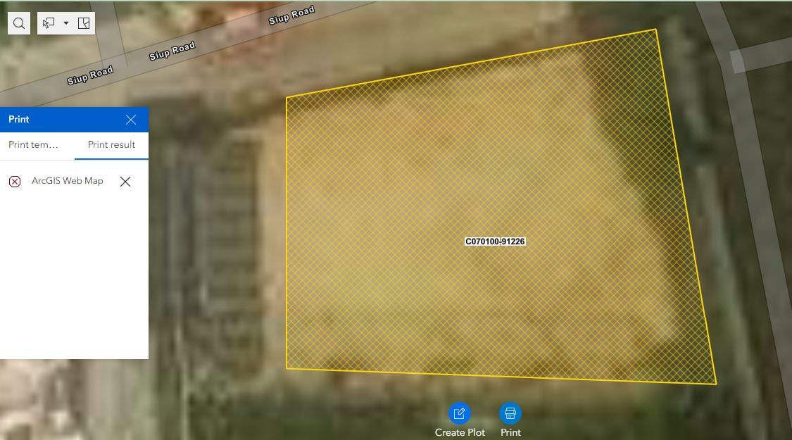

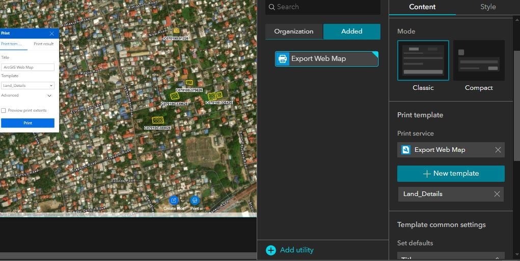

Next, I've used the service URL of this tool in ArcGIS Experience Builder, where the layout name is correctly showing in the template. However, when attempting to print, I encounter an error.
The error message states "Unable to complete operation".
If anyone has encountered a similar problem or has any insights into how to troubleshoot and resolve this issue, I would greatly appreciate your assistance.
Thank you in advance for any help or advice you can provide!
Best regards,
Akhil Raj TError.JPGExperiance Builder.JPGShare As a web tool.JPGWebtool.JPG

AkhilRajT
@ArchitSrivastava  Thank you for providing those instructions. Upon investigating the logs, it appears that the error stems from a failure to create a layer from a service. Export Web Map : Failed to create layer from service at https://************/server/rest/services/dev/GIS_Plot/FeatureServer/0. Failed to execute (Export Web Map). This issue arises during the execution of the print tool.

A_Wyn_Jones
Printing services have to be synchronous for ArcGIS Experience builder: https://enterprise.arcgis.com/en/portal/latest/administer/windows/configure-services.htm#ESRI_SECTIO...
Can you confirm it's been configured as synchronous?
