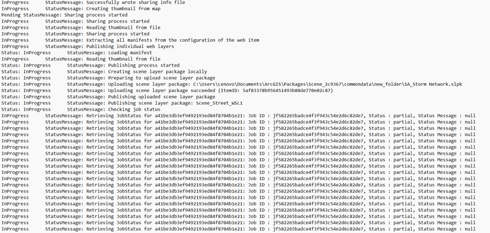

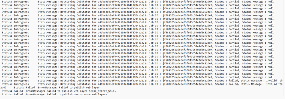

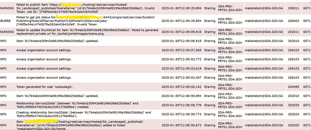

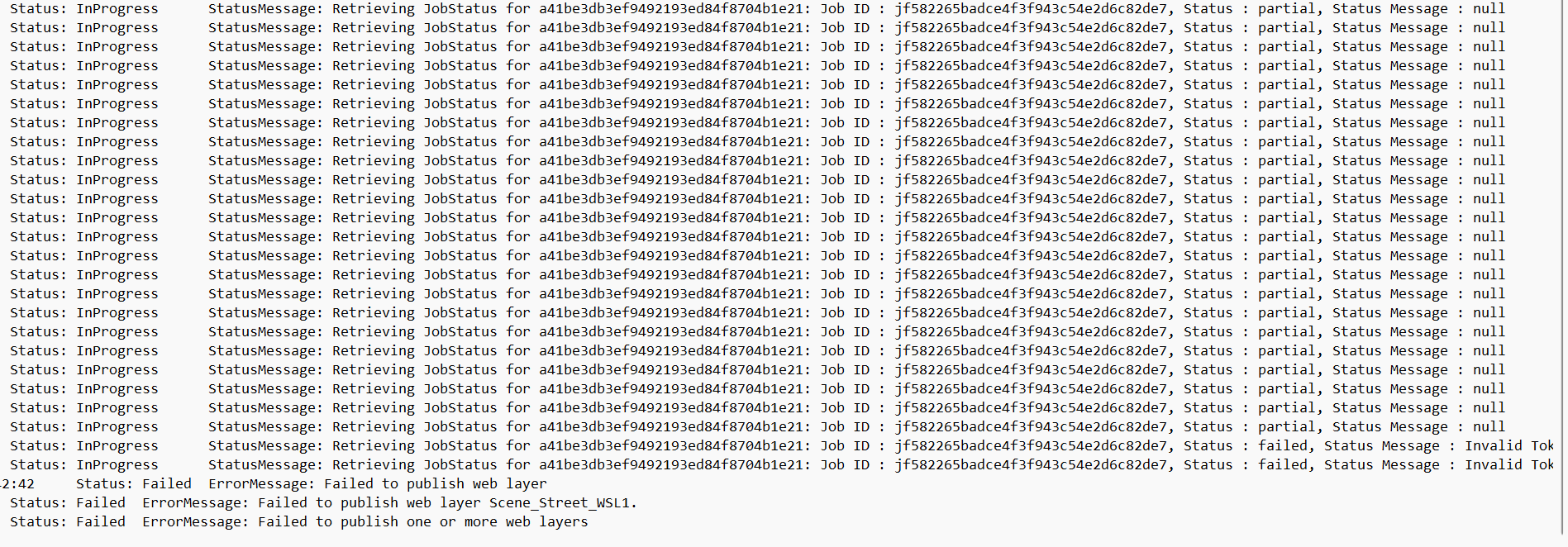

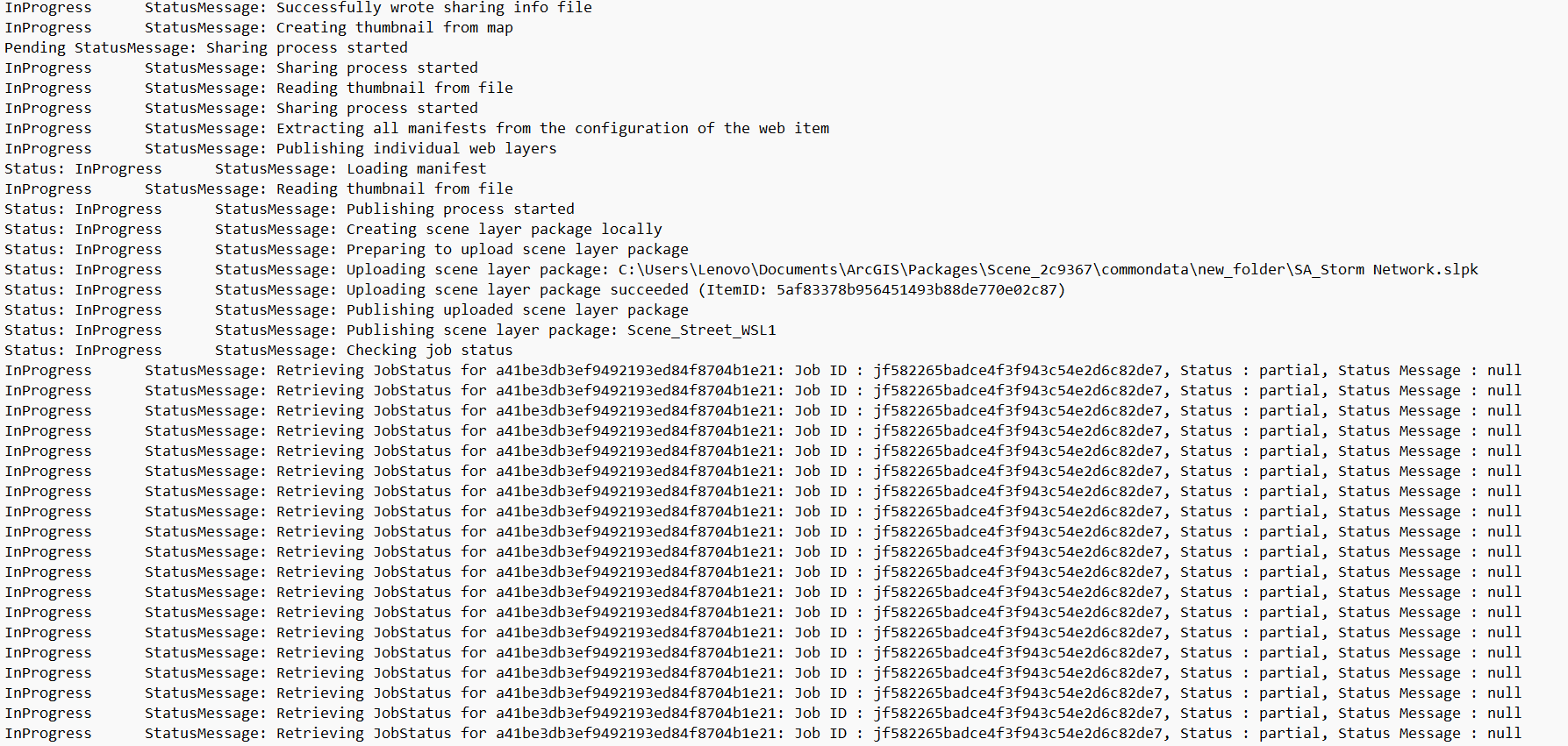

I am encountering an issue when attempting to publish an SLPK from ArcGIS Pro to ArcGIS Enterprise. The publishing process fails with the attached error message from ArcGIS Pro. Additionally, I noticed several logs in the Portal that include the following message:
StatusMessage: Retrieving JobStatus for a41be3db3ef9492193ed84f8704b1e21: Job ID : jf582265badce4f3f943c54e2d6c82de7, Status : failed, Status Message : Invalid Token

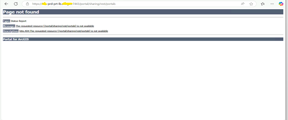

It appears that ArcGIS Server is trying to generate a token from the Portal sharing REST API but cannot do so. After further troubleshooting, I found that the URL passed to the Portal is being redirected by the internal load balancer, as shown below:
- Passed URL: `https://abc-prd-prt-lb.domain:7443/arcgis/sharing/rest/generateToken`
- Redirected URL: `https://abc-prd-prt-lb.domain:7443/portal/sharing/rest/generateToken`

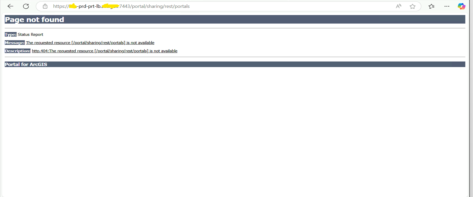

and this resulted not found page as the attached

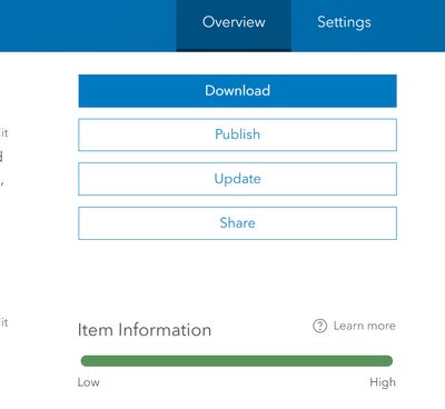

after the manual share to portal, does that publish button succeed for you?
MarGIS

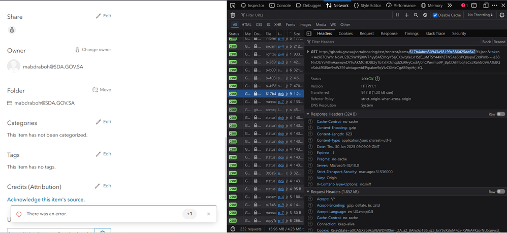

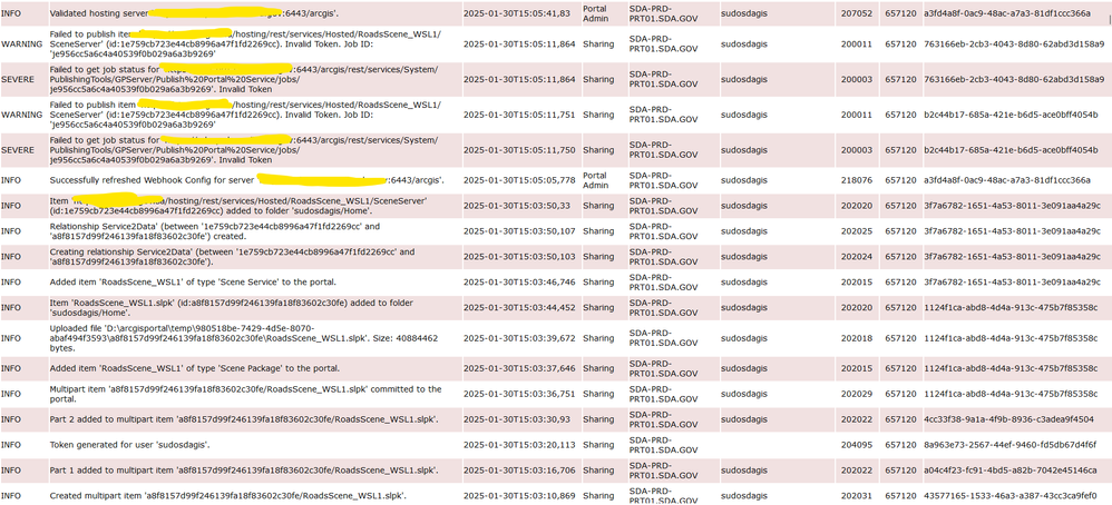

I tried to publish but it failed. You can see the screen named (WebDeveloperTools). When I did not find any error in the browser, I visited Portal Logs and Found the logs in screenshot named (PortalLogs_edited). I tried to republish again from ArcGIS Pro and collected the logs in sequence regarding the process from start until it failure in screenshot named (PortalLogs2_edited).
