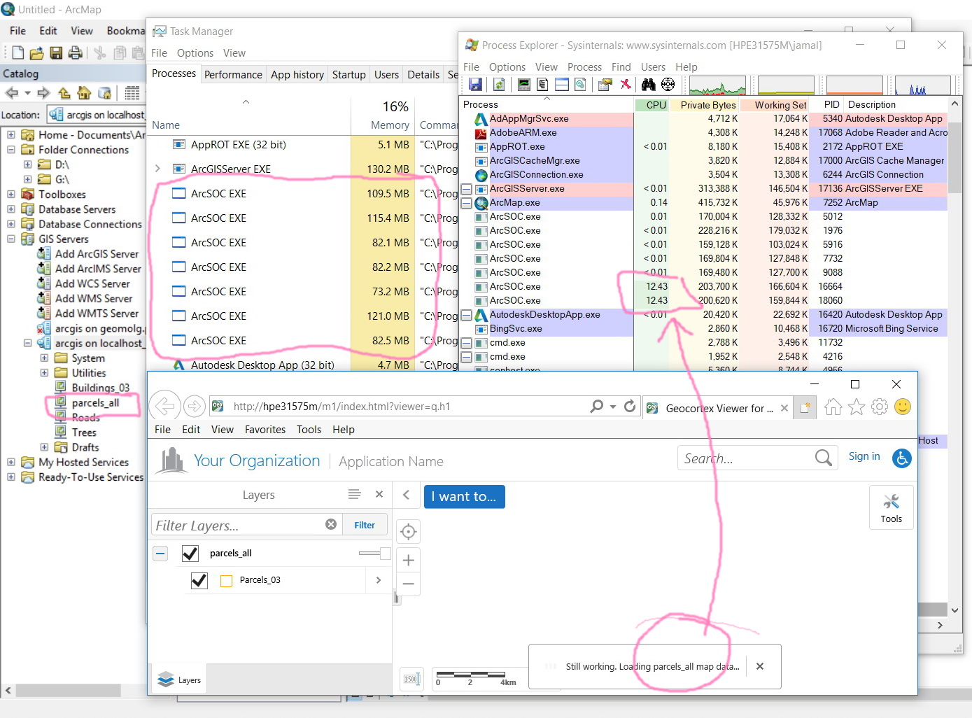

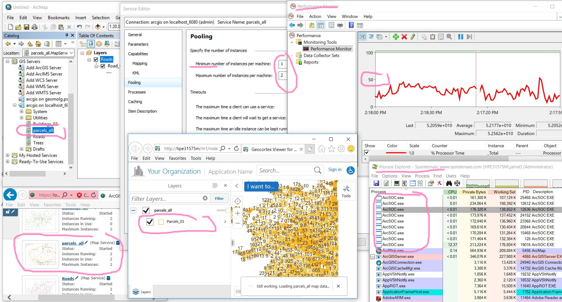

For example, for the service indicated in the screenshot below, “the maximum number of instances per machine” is set to be 7. Does this mean that the if we have 9 CONCURRENT (simultaneous) users, then 7 of them will be able to display the service while the other two will be waiting?

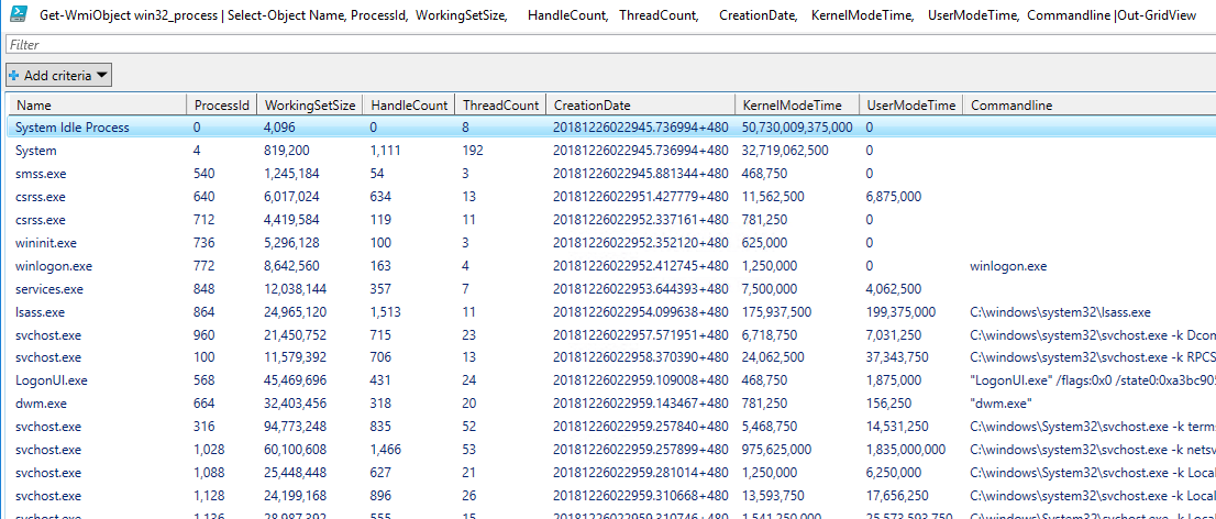

Sorry  'Task Manager' (WIndows Task Manager) does not display the time that each process started (My mistake).
You can get this information via Powershell
Get-WmiObject win32_process | Select-Object Name, ProcessId,  WorkingSetSize,      HandleCount,   ThreadCount,      CreationDate,    KernelModeTime,    UserModeTime,  Commandline |Out-GridView
In your case all the ArcSOC CreationDates should be around midnight last night. If there are other start times then, while that start was occuring, there will be an elongated response for the request that caused the start and potentially elongated responses for other requests that arrive while the start is being actioned.
To chase why you have start times away from midnight you need to look at the ArcGIS logs

In a test environment, we have been trying to understand service performance when executing actions such as panning, zooming, quiring, etc. We found out that, for example, zooming a service that contains a layer of 300,000 polygons is really a heavy action and would consume around 12% of the CPU (machine specs: 3GHz CPU, 4 Cores, 64 GB RAM, 2133 MHz). This means that if 10 users are zooming at the same time, then the CPU will get full just from zooming action on a service!
Zooming actions consumes on a service 12% of the CPU
Each ArcSoc.exe occupies around 80 MB on the RAM
Then imagine that we have 100 or 1000 users are zooming at the same time. Does this lead to the fact that no any server what the specs are will be sufficient to take care of services?
The issue gets complicated to be explained if we wanted to know how actions (such as pan, zoom, query, etc.) are translated in terms of requests, and then to figure out the number of ArcSoc.exe needed to serve these requests\actions
