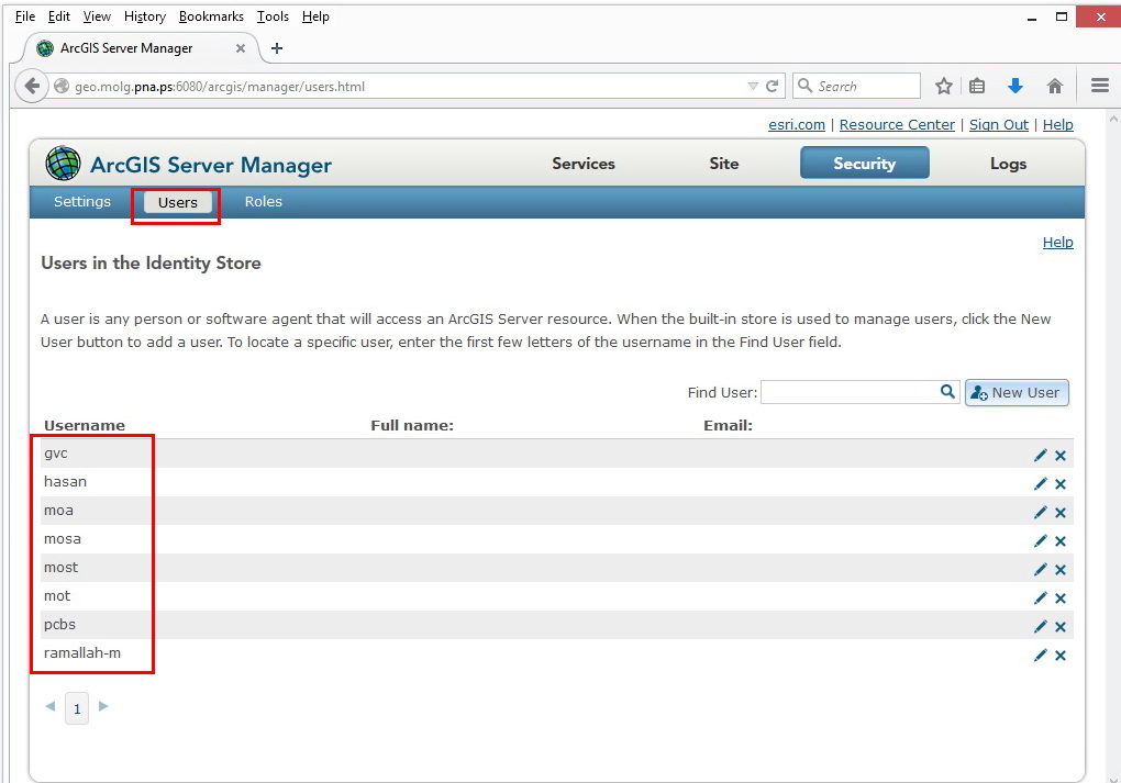

I couldn’t figure out where the users\roles of the ArcGIS Server are stored. This is important in case the users\roles are required to be copied from one machine to another in case of failure.

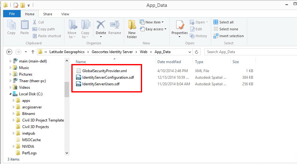

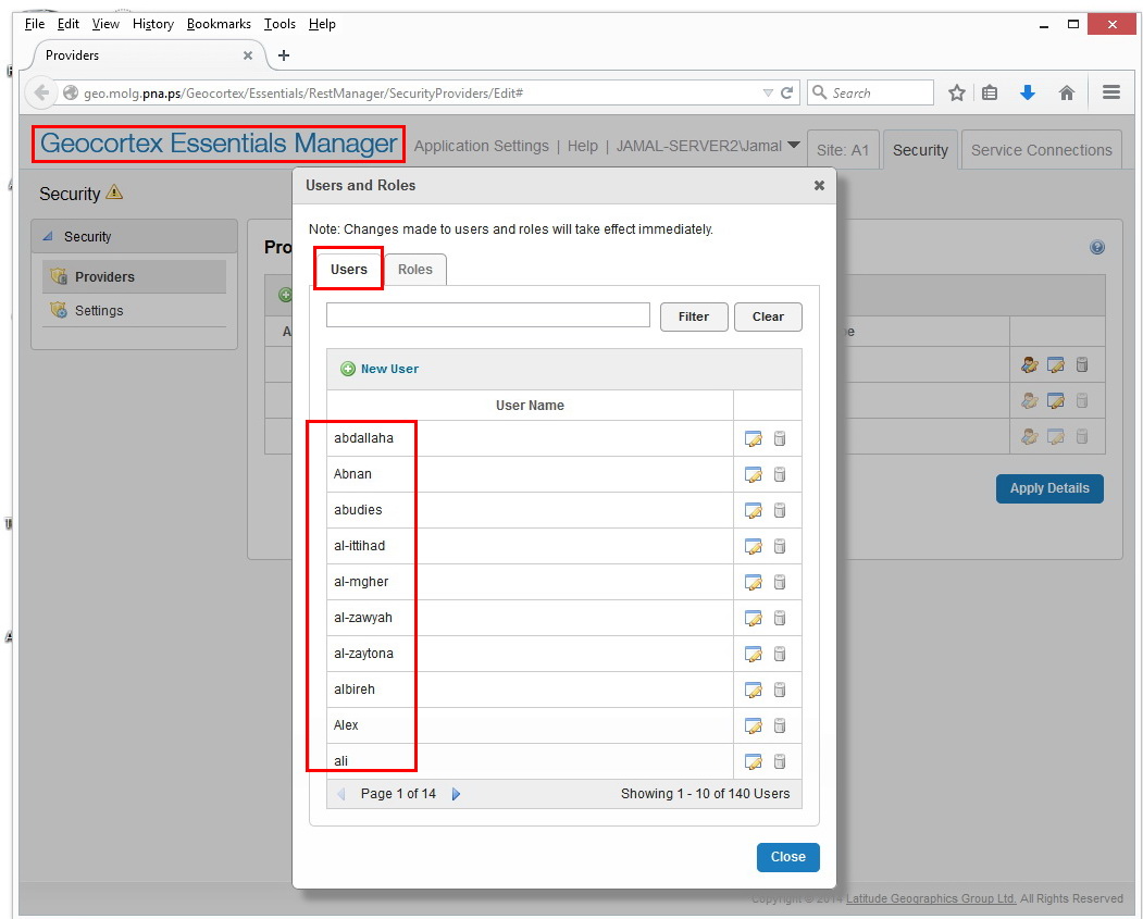

For example, the users\roles of the Geocortex are stored in the sdf file and can be copied from one machine to another.

Hi Jamal,
The users/roles are stored in the C:\arcgisserver\config-store\security directory.  However, I've never tried copying to another ArcGIS Server instance, so I'm not sure if that will work.
